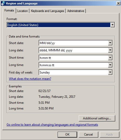

It will be hard to find reason without the device. I've never had such issue. Data is stored in internal flash - the same FLASH memory is used for GUI graphics. If GUI is working ,than FLASH is fine too. If UTCOMP is working and is connecting with USB that it seems that firmware is working fine too. So, by deduction, I guess it is something with os. Software for .csv file (open office etc.) does not matter - your file seems to be corrupted and it has only 1.5kB. So it seems that it is something with downloading data from UTCOMP or with saving downloaded data to file. Downloading data is probably fine, because you can read UTCOMP settings (I guess). You can check also if you can download FLASH GUI graphic file (viewtopic.php?f=28&t=54) - it should have 64kB. If it works, than only saving data to external file is not working properly. The questions is - why? It will be hard to answer for it because it is working fine for me and nobody had similar issue. I'm thinking that it is maybe something with system localization settings (control panel -> region and languages) - there are some settings for language, data formats, localization country etc - could you tell me what settings you have set so I can test it with the same settings? (screenshot will be fine)

Postby Daily_Driver » Tue Feb 21, 2017 11:35 pm
Screenshot attached. Everything beyond that such as locale is English United States.
