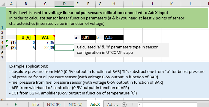

Manual says 7.35 AFR to 22.39 measurement range for 0-5V output,
so 0V = 7.35AFR and 5V = 22.39AFR,
using excel formula from 1st post in this topic: viewtopic.php?f=28&t=58
it will give
a = 3,01 and b = 7,35

Thanks a lot for your support.
It works perfect now ;)
