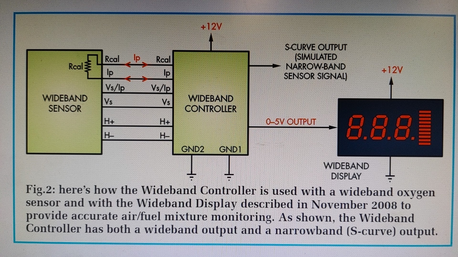

Postby Toomas » Mon Feb 15, 2021 12:30 pm
Hi mate, and sorry for late reply, its but hard to get the information! Here is the connection diagram
Re: AFR installation
Postby ArT » Tue Feb 16, 2021 8:51 am
On schema is "0-5V OUTPUT" to display - the same output will work with UTCOMP AdcX input but you will need to know also scaling (how 0-5V output is scaled to AFR value in your controller)
