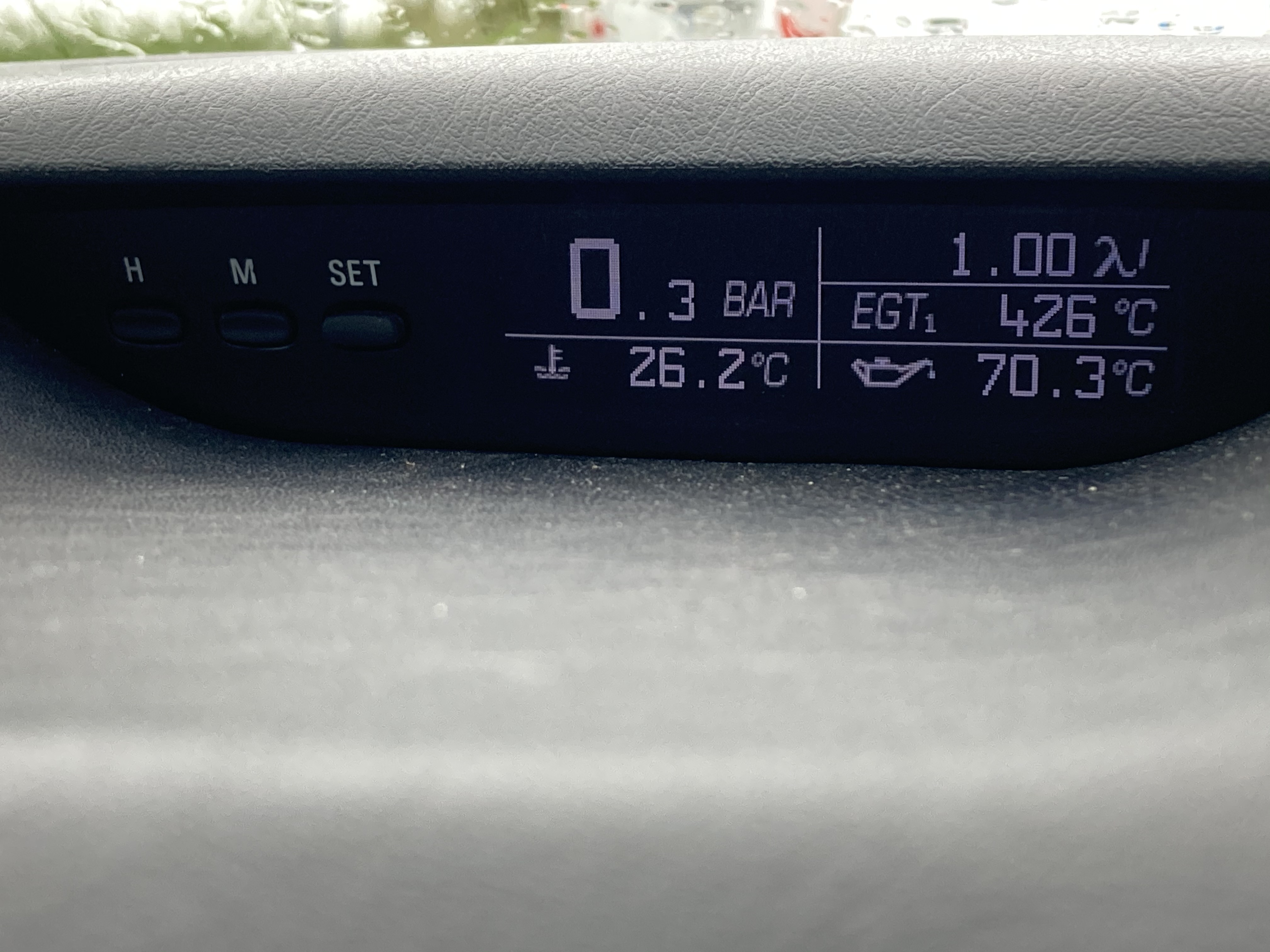

On the display I see a start-up picture but very dark when I turn the key on. The clearly see that I uploaded a start-up picture with reversed contrast (white background).

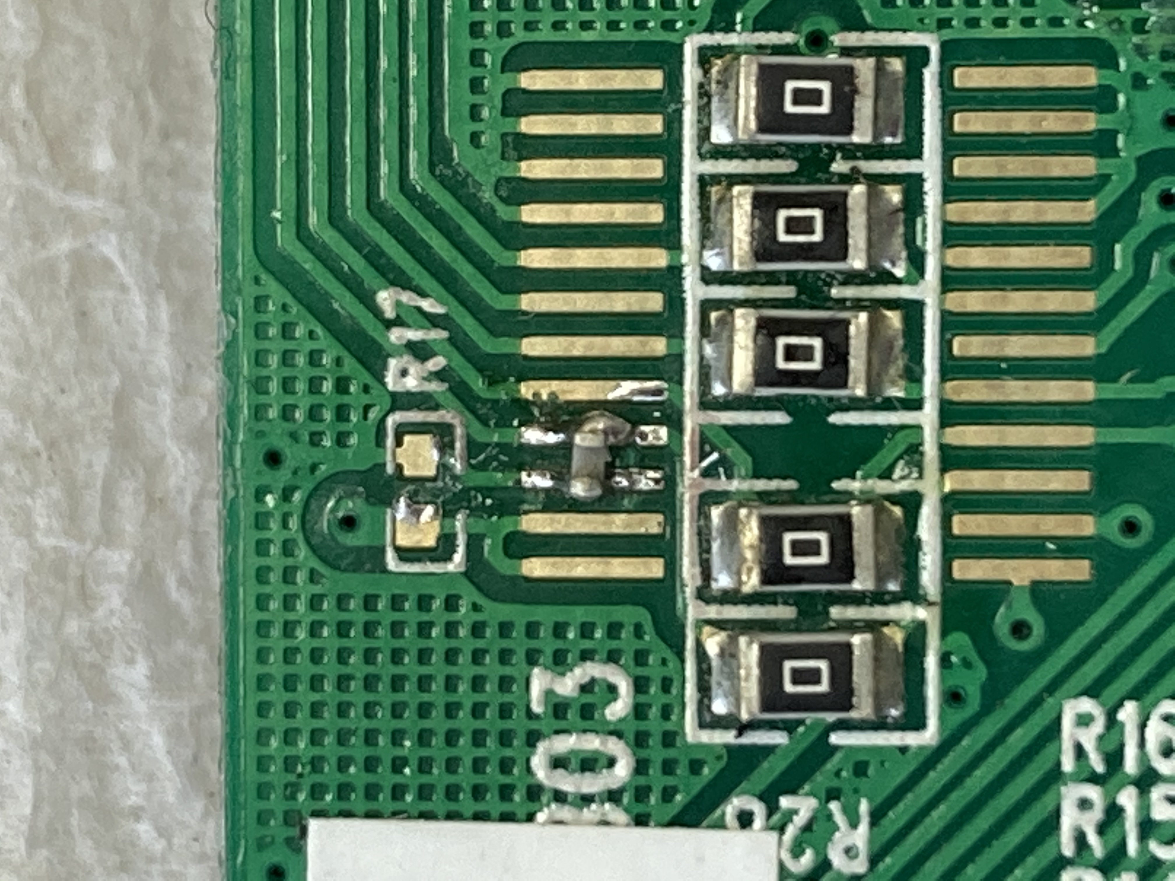

Hello Artur, I pulled the display out, to have a look on it. To me it seems like the Resistor (R17) got hot and fell off or so (see picture). Doesn't look right like this. I will see if I can fix this otherwise I will send the unit in for a check and order a new display.
Any Idea what the resistance value might be?

It looks fine. R17 is not placed from factory. This small cap between pads is also mod from factory.
You can send unit and display for checking, we will see

Thankfully I got the display back last week. Everything works as before.
I didn't expect the repair service to be that "pricey" though :) Thank you again for the quick help!
