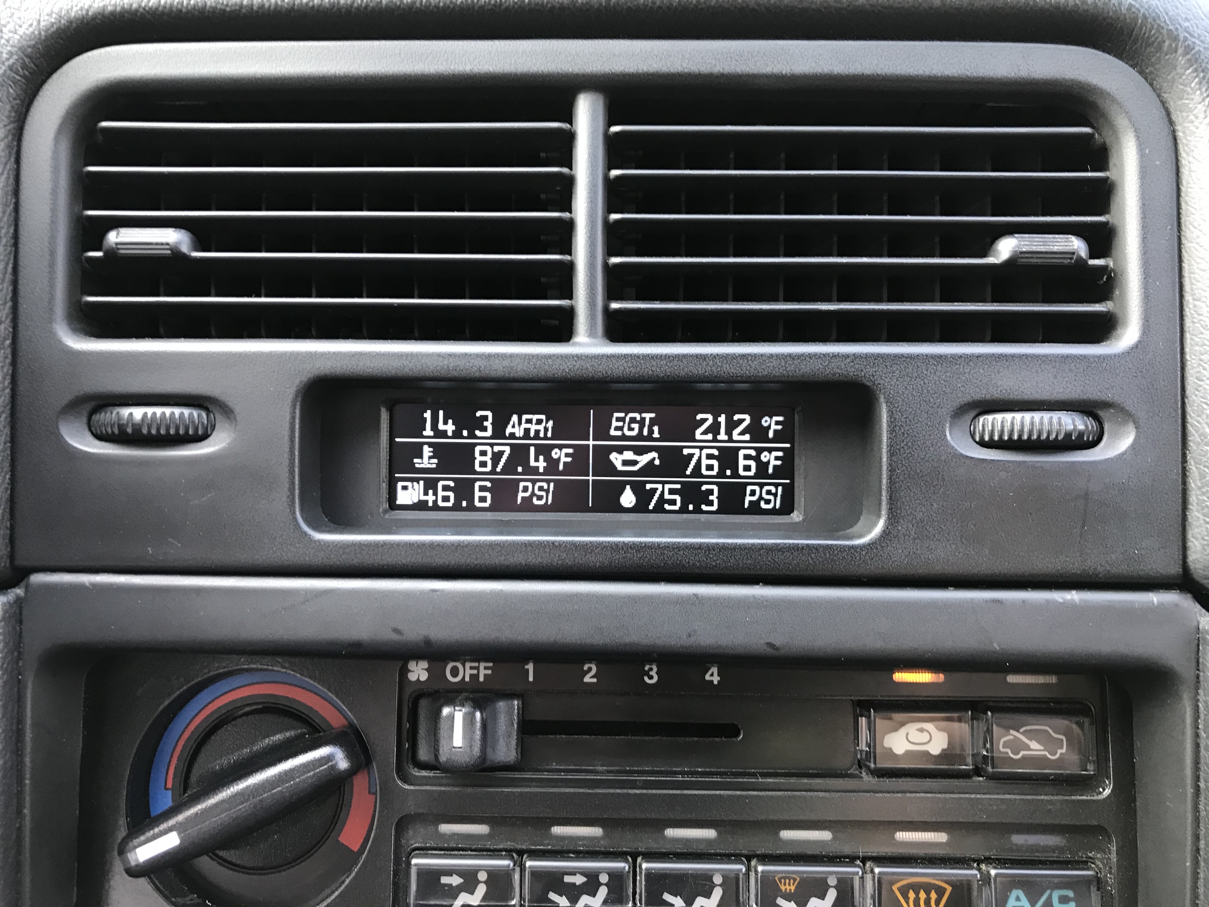

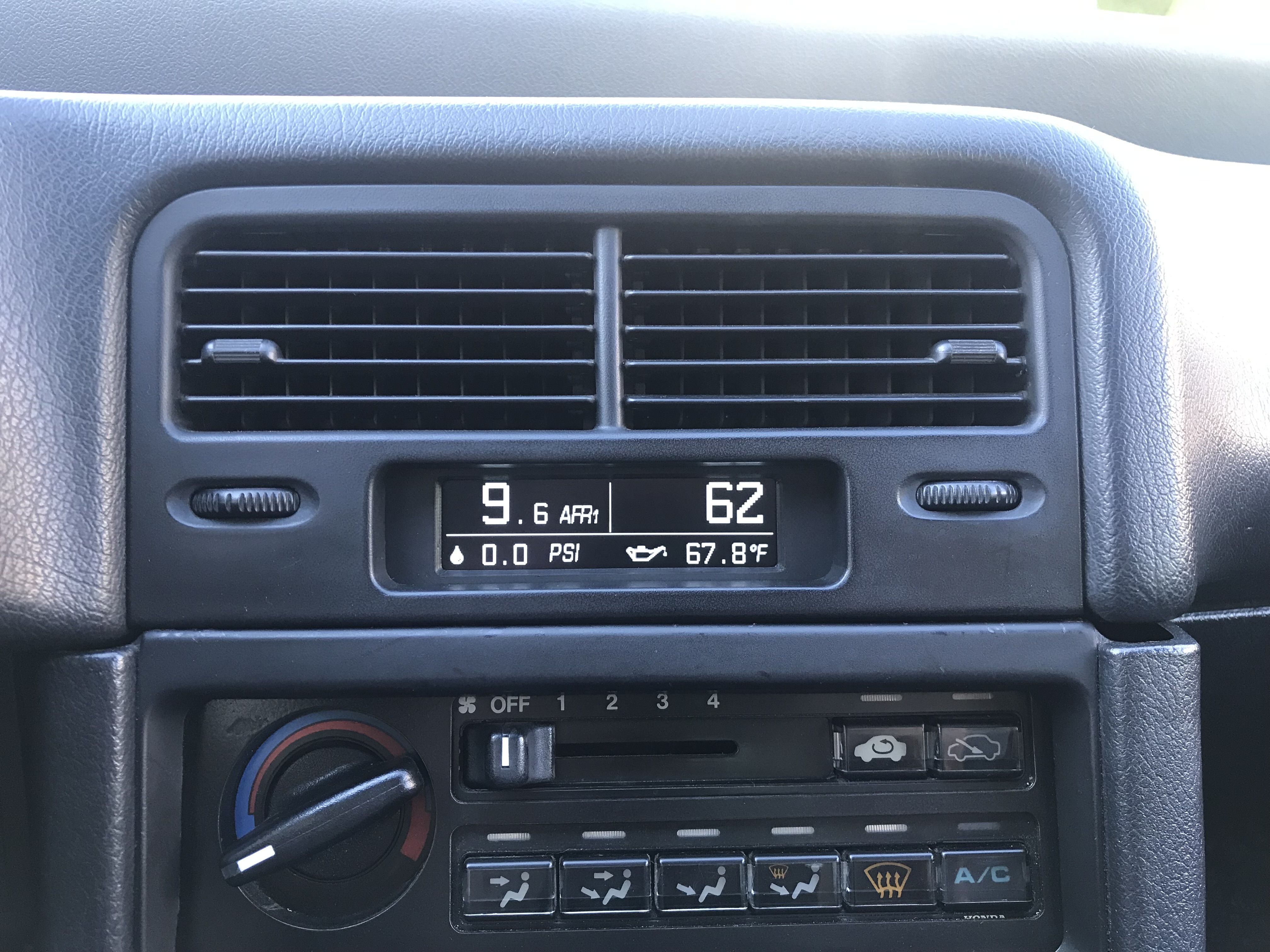

When I choose EGT on this screen it only shows the numbers, no icon. Is that a possible bug or did I possibly do something wrong?

Another bit of info is I have EGT selected on User Screen 4 and it displays normal. I would think if the icon was missing it would also not appear on this screen but it does.

Jason, I got it. On my UTCOMP-PRO, EGT icon is also missing in this area. After short investigation - it's intentional :P For areas: UL, UR, A and B, EGT is displayed without icon because when you display 4 digits (maximum range is 1250C) there is no enough space for icon next to this big font.
