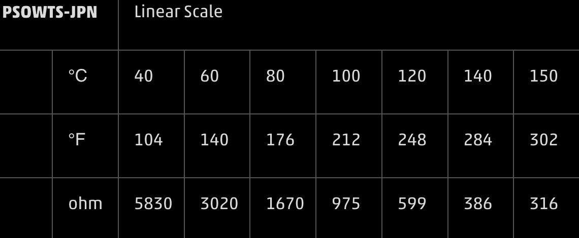

I have attached resistance table diagram below.
Thanks for your help!
Resistance table

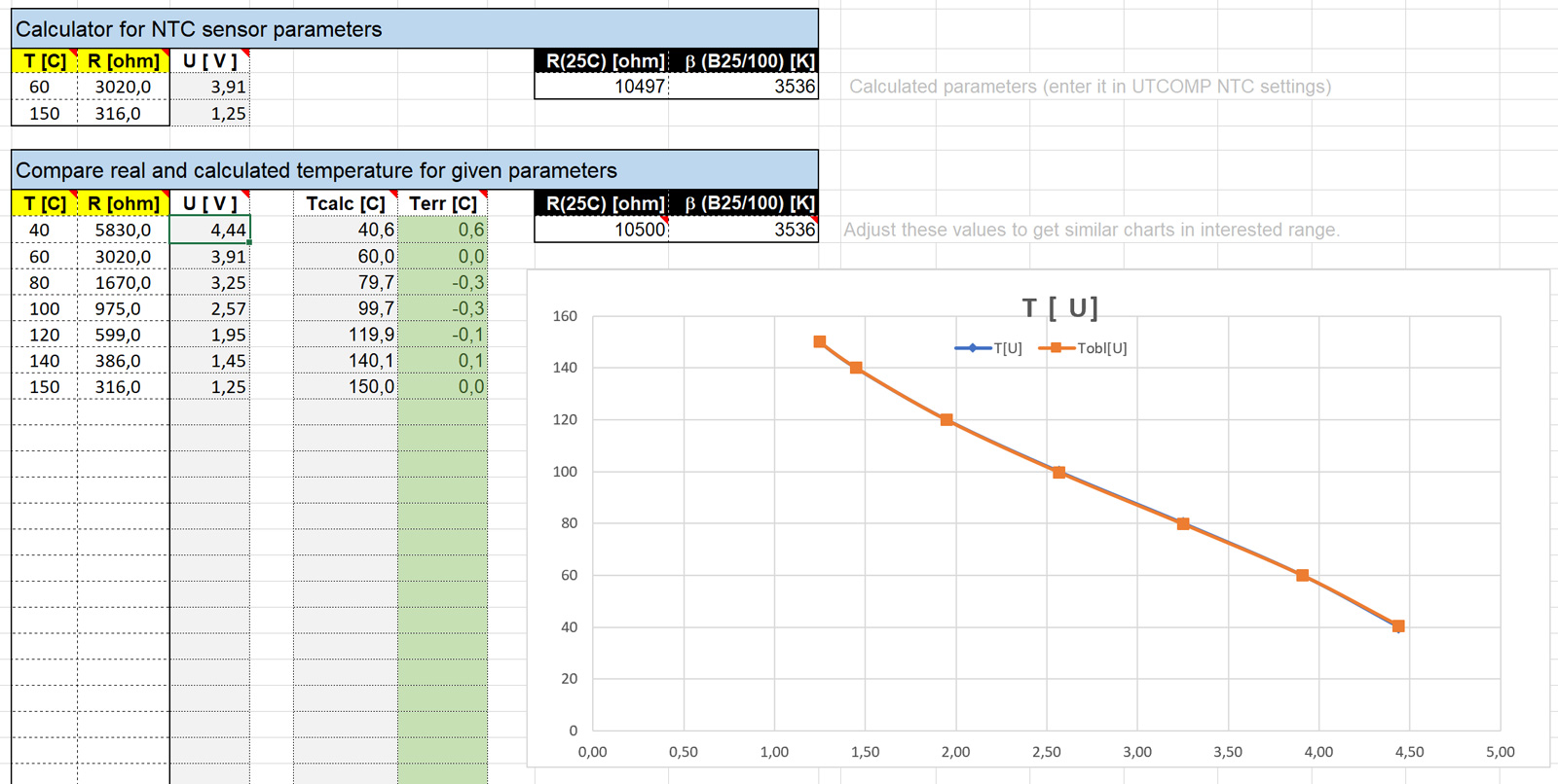

Please use calibration data for above sensor:
R25 = 10500
Beta = 3536
It should work above >40C. Below 40C readings may be inaccurate because I can not see scaling table below this range.
