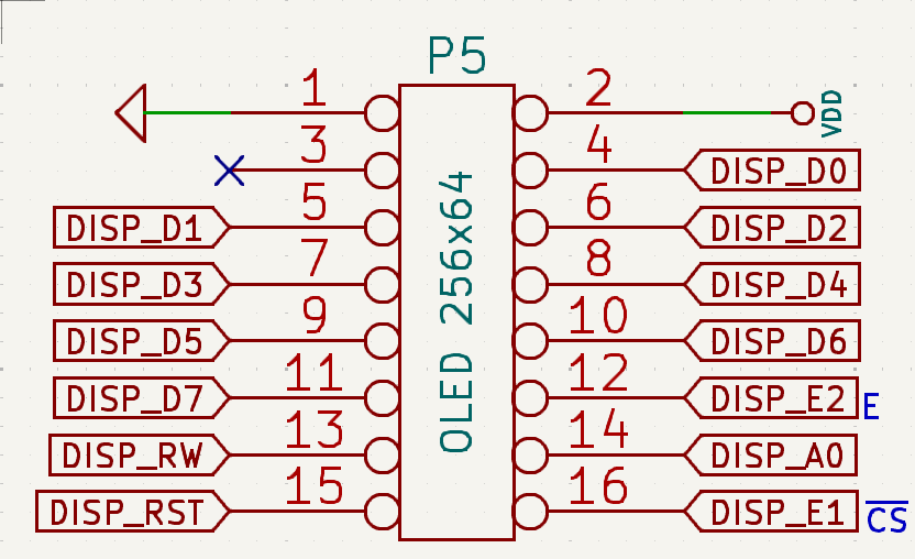

Here you have connector pinout for OLED:
2024-02-21 110710.png (49.44 KiB) Viewed 20732 times
VDD = +5V
I checked datasheet of NHD-3.12-25664UCW2 and it does not tolerate +5V power supply (max 3.5V) - seems it does not have DC/DC converter on board. Interface is the same, but unfortunately it will not work, it will be damaged after connection instantly.

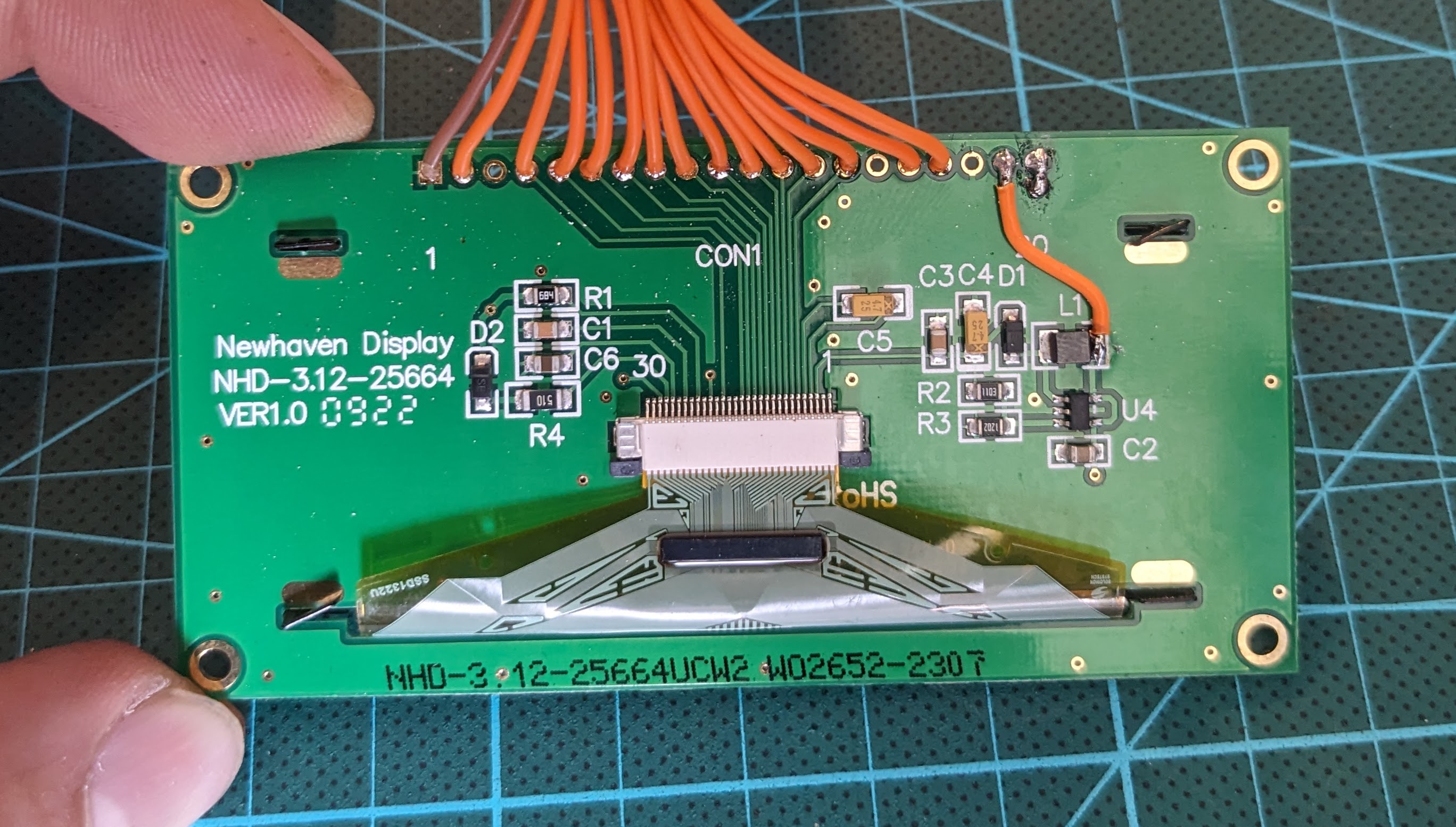

Thank you for the voltage warning. I looked on the OLED PCD in this thread: https://forum.reveltronics.com/viewtopic.php?f=19&t=918. There is more components, but mostly zero ohm resistors (probably as posible voltage dividers? I don't know.). The OLED glass itself looks same.

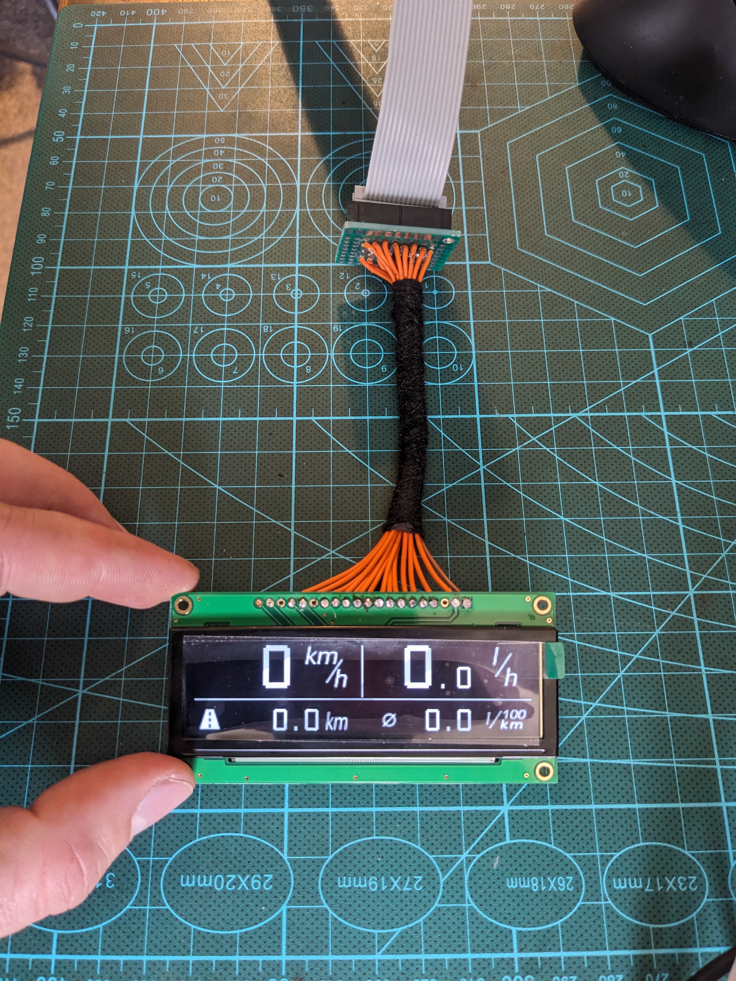

So I made the wiring and give it a try. And it works. SSD1322 and other components are cool, nothing is overheating. I suppose, that the SSD1322 is 5V tolerant even that is not mentioned in datasheet.

Interesting. Please observe it carefully, you may have voltage drop on 1m flat cable. There is no resistors in series, but there is DC/DC converter on OLED board for VDD (+5V -> +3.3V)
