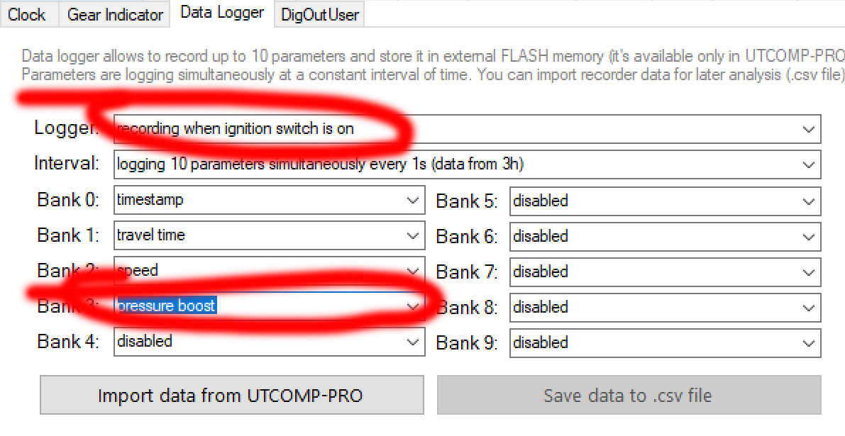

Postby ArT » Mon Mar 25, 2024 9:58 am
Have you updated your settings with parameters I have marked on screenshot below? In settings file you have shared data logger was disabled and recording boost pressure was also disabled.
I've never measured exhaust gas back pressure, first you will need to find out possible pressure range, and secondly you will need find pressure sensor for such range which will operate also in this temperature range

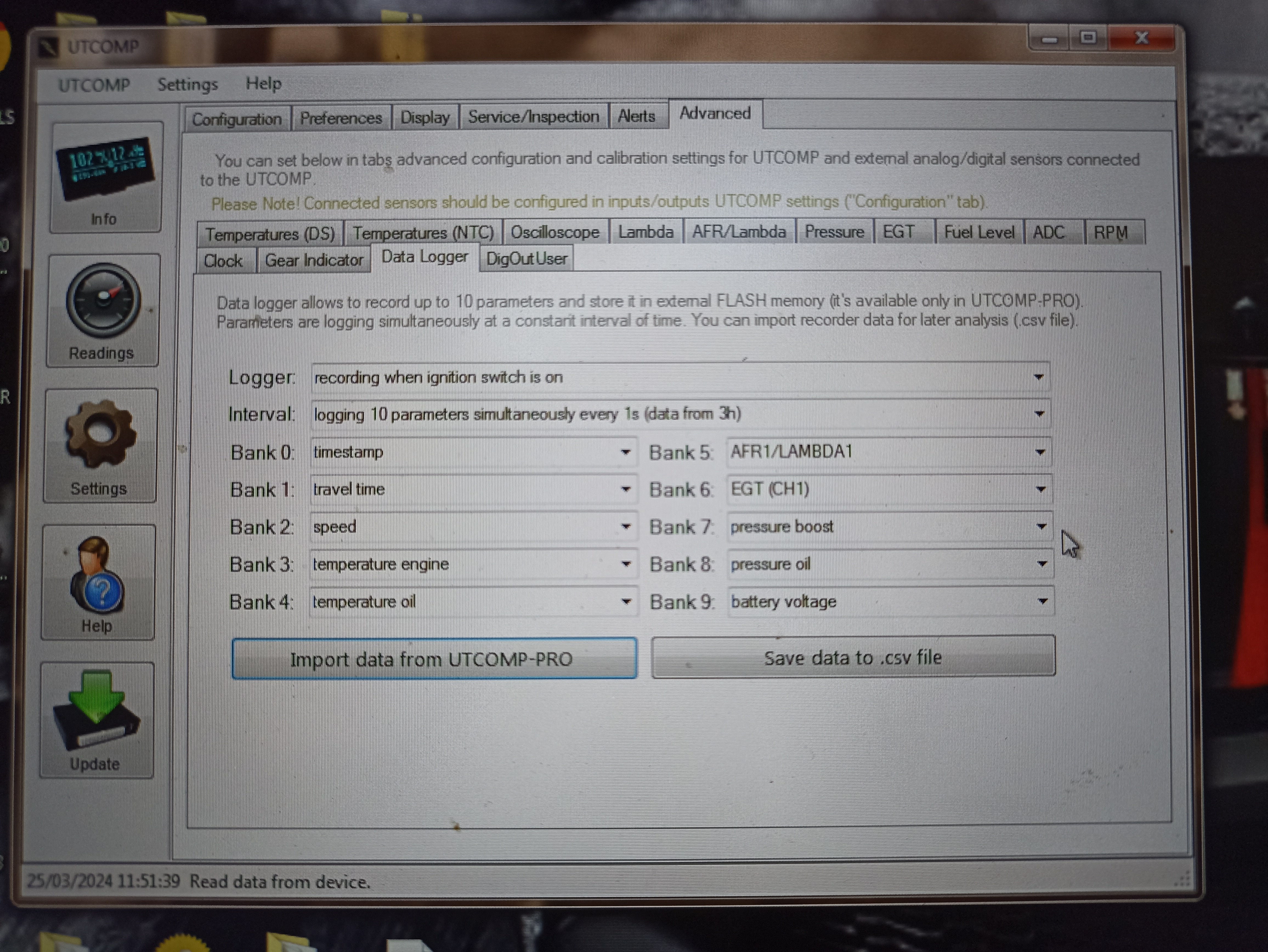

Postby Massimiliano » Mon Mar 25, 2024 11:55 am
Yes

Postby Massimiliano » Mon Mar 25, 2024 2:10 pm
her
her
Re: turbo pressure sensor calibration
Postby ArT » Tue Mar 26, 2024 9:54 am
Now it's fine. Please share me your data logs file (.csv) from last 3 hours after settings were changed.
