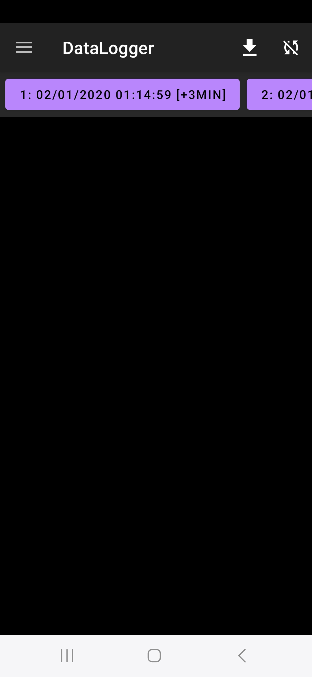

I disconnected the battery on my car while I did some engine work.
Now the Timestamp in the logger is the wrong date (see screenshot).
How do I check and update the system date?
Thanks,
Dave

Hi Dave,
If you have connected keyboard and display, you can press longer SW1, go to clock/date settings from menu. There is also option to connect UTCOMP via USB cable, run UTCOMP windows app and save settings - after saving settings in UTCOMP Windows app via USB - time will be synchronised with current PC time
You can also install latest APK for android (still not official) where it should update time in UTCOMP everytime it connects

Thanks Art,
I have already connected my laptop. How can I check that the system clock is now correct?
Re: Utcomp system date
Postby ArT » Thu Aug 08, 2024 3:11 pm
Only on display. If you have version without display (android only) it will be visible only in data logs.
