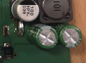

Please check the capacitors inside, as they may need replacement after all these years. First and foremost, replace the two goldcaps (supercapacitors functioning as small batteries). These are the green components shown in the picture:
Zrzut ekranu 2024-12-04 092745.jpg (17.1 KiB) Viewed 106201 times
The current components are DRL105S0TF12RRASP, but you can use any other capacitor with a minimum rating of 1F and 2.7V (0.5F will also work). This should help resolve this type of issue. If not, we will investigate further. You can also send module to our service and we will check it.

I replaced both of them as you recommended (one of them already had a big ‘bump’ on top) and UTCOMP now starts as it did all the years. Will observe it for a couple of days now but I think the problem is solved - thank you very much!
