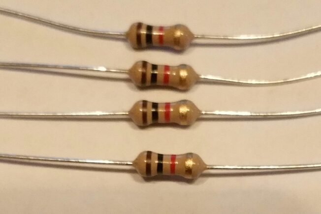

I tried to search on the internet to check the colours of my resistors and it seems like brown black red gold should be 1k ohm: I assume it's not possible to read it the other way around since I did not find anything starting with gold. since it's the first time I use such object I do not know if I can connect it in both ways or it gives a different result if connected reversed. since I insulated it with heat shrink I could not see how it is orientated. I simply soldered 2 pieces of wire to the resistor and connected the wires to b12(it was not a free position so it is supplying 5V to 2 sensors) and B2
Re: problem with NTC setup
Postby ArT » Wed Aug 04, 2021 8:51 am
It's 1kOhm with 5% tolerance, so it can be 950-1050 ohms. It can be connected in both ways, it does not matter. Do you have multimeter to measure resistance of resistor and measure voltage on B12 output? So I can calculate you better scaling parameters for this case.

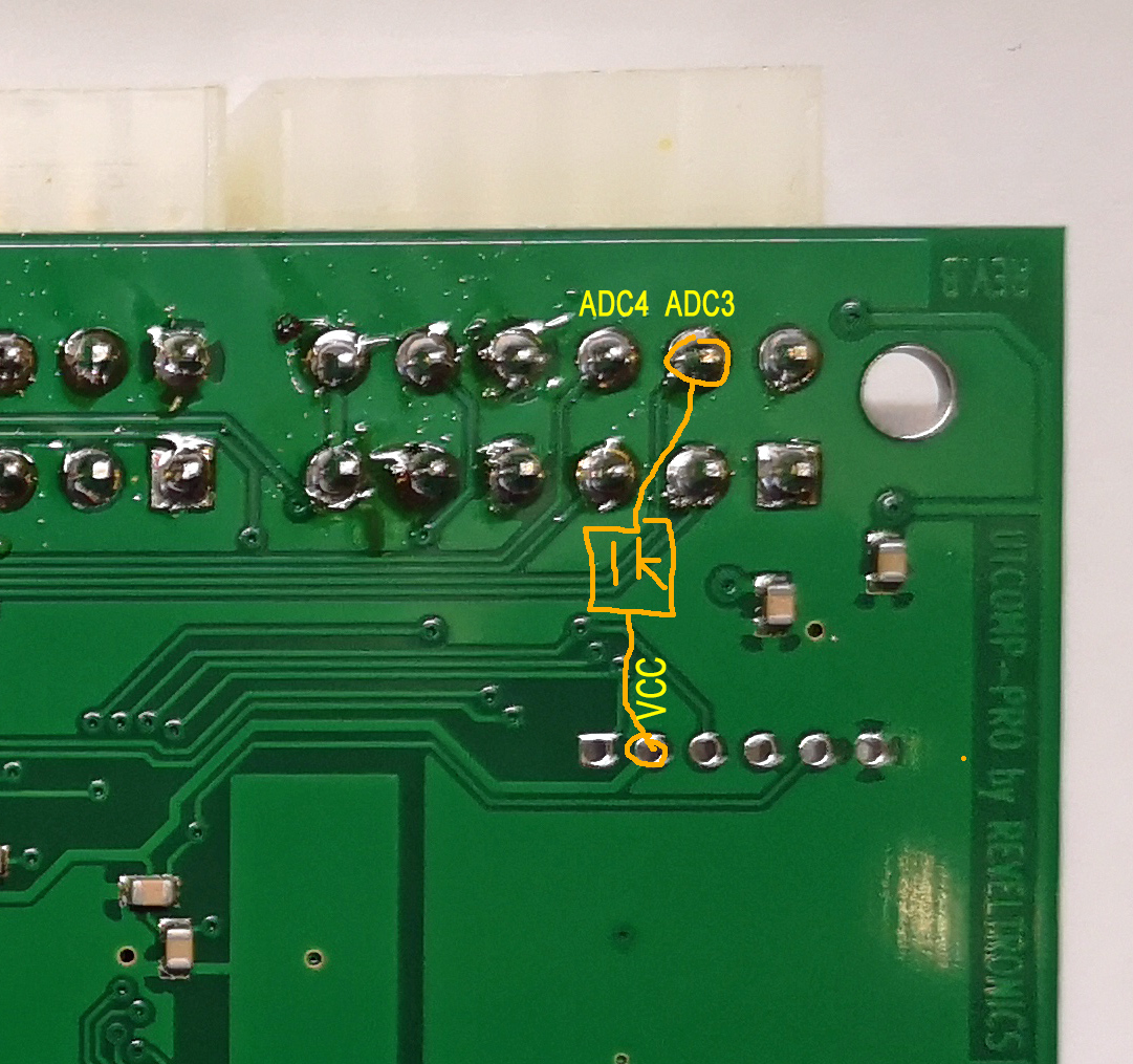

Yes it can be the difference, but from my calculations you should read higher temperate not lower because you will have slightly lower voltage on sensor (lower voltage = higher temperature) so it all does not make sense. I can't figure out where is the issue, but I suppose that DS18B20_VCC is not a good voltage reference when you have connected any DS sensors. Could you open UTCOMP and make this mod inside so you will get voltage from inside instead of from DS18B20_VCC? so you will get exactly VREF (around 5,2V).
I marked you where you should connect 1k ohm resistor inside (between Adc3 and VCC). Please protect it to not touch to other pins.
