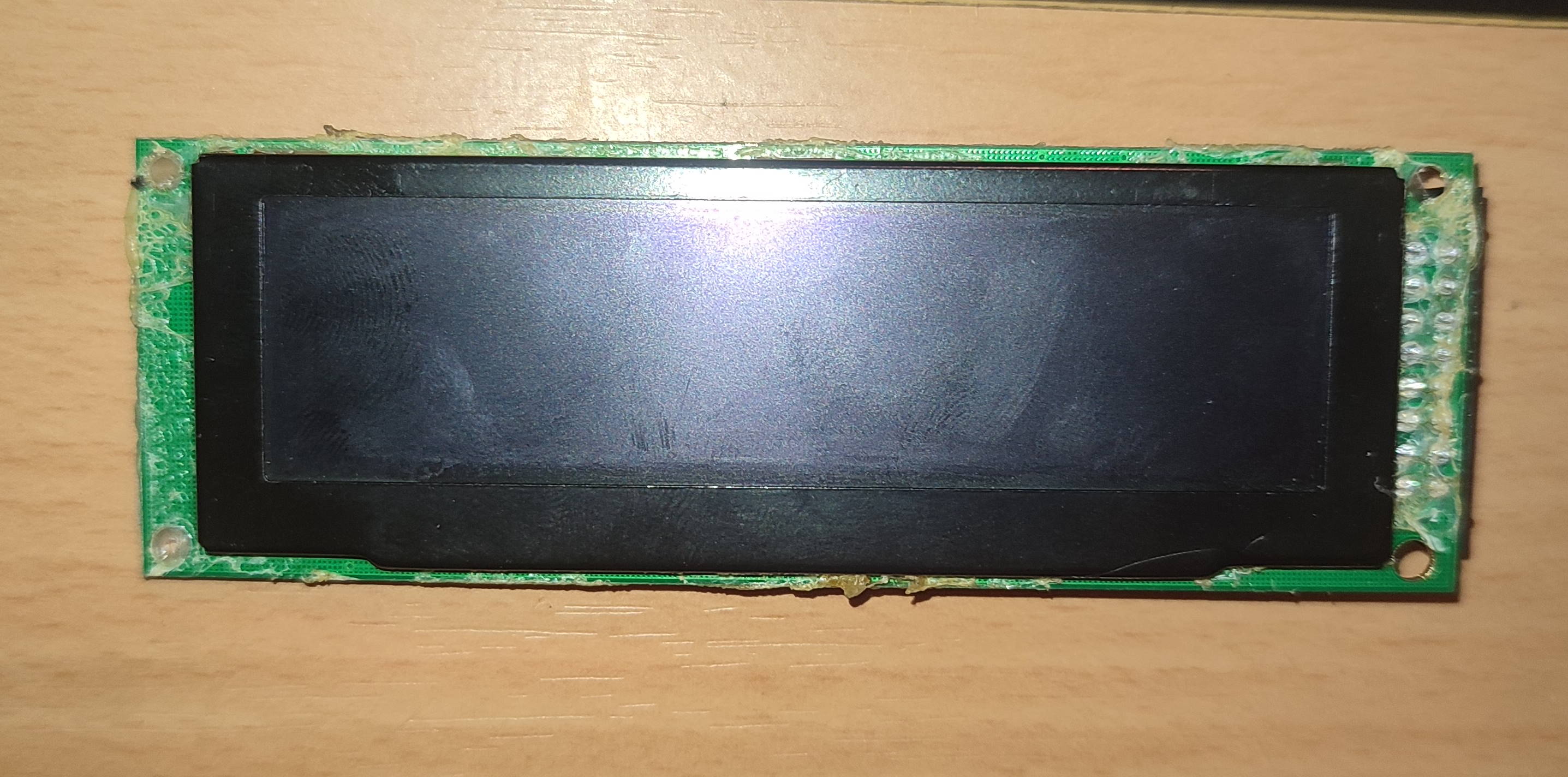

with a new screen all is good...Thank you the utcomp is ok ! I'send for gift the old utcomp and screen to a friend. he will repare screen ore buy a new one thanks !

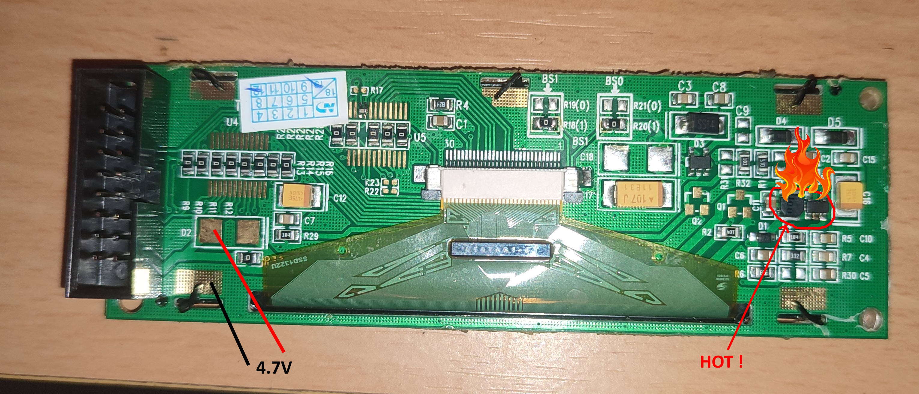

ArT wrote:Please check if you have +5V on display (with ignition switch ON), maybe tape is corrupted.
Can you show me where i need to check the 5V on the display please ?
ArT wrote:Is it new screen?
No, old faulty one. (but with another new screen, it's ok)

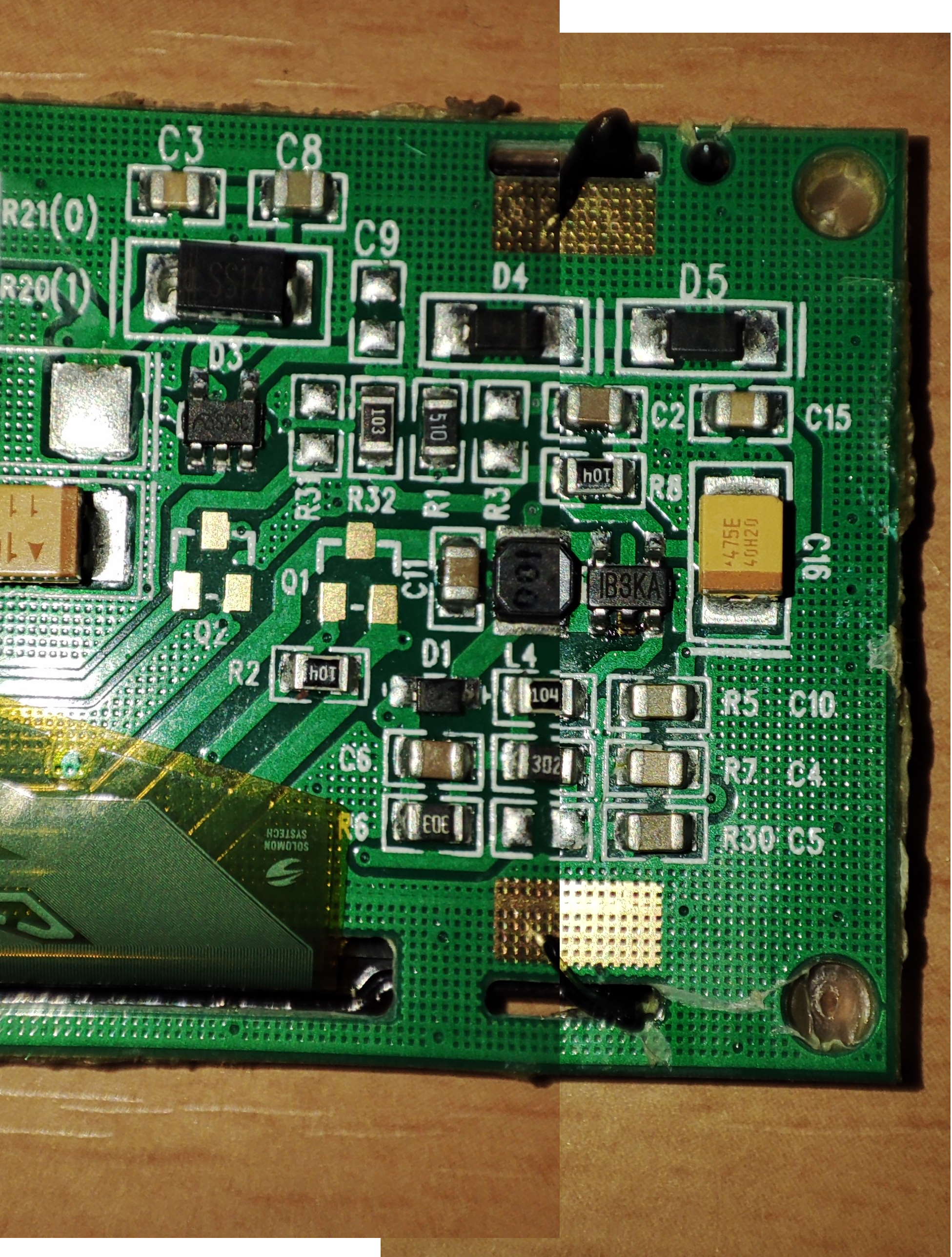

ArT wrote:Please send me a board photo of this screen.

Postby liryc » Wed Jan 25, 2023 12:11 am
i have a constant 4.7V here
And i feel HOT component arround here (not sure witch one on both)
