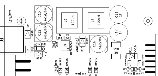

Ok seems like sth with internal DC/DC converter. There are few +5V lines used for internal logic. +5.2V is used for MCU. +5.2V ON/OFF (based on ignition signal, T1 is used) is used to power internal peryph, like additional flash memory. +5V ON/OFF (which is +5,2V ON/OFF after D11) is used to power display (T2 is used), buzzer, user switch and DS sensors.
Please check 2x 1F goldcaps (C17 and C18) on board if they are still functional:
Zrzut ekranu 2024-02-27 095154.jpg (46.6 KiB) Viewed 65622 times
You can also send unit to us and we will check it. Details on PM.
