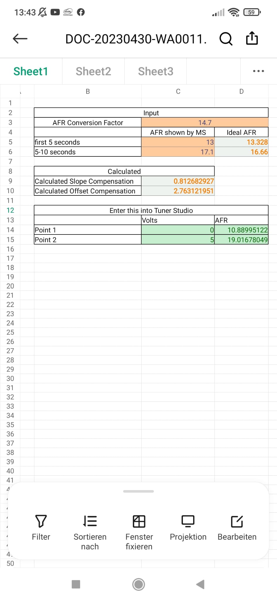

Hello, can someone help me calibrate my spartan 2 wideband controller :oops: The attached files is all I could find from the manufacturer. I hope someone can help, thank you :D

If Point 1 = 0V = 10.89 AFR and Point 2 = 5V = 19.02 AFR then:
a = 1.63 and b = 10.89
You have compatible calculator in settings -> advanced -> pressures or excel in this topic:
viewtopic.php?f=28&t=58
