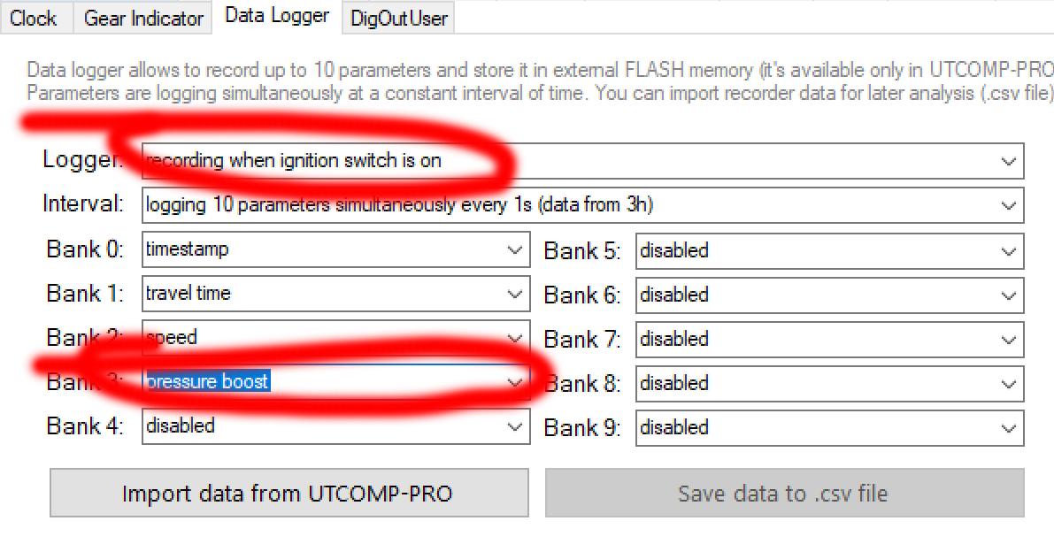

HI,
I downloaded the datalog, but I always have the turbo pressure at 0.6, but on the utcomp display it works up to 1.6bar
How come ?
Thank you

Postby ArT » Tue Mar 12, 2024 9:25 am
I see in logs old data from 2023-11-26 and later from 2024-02-12. Seems like this is data with old setting and now datalogging is disabled. Please make sure that you have enabled data logging. If you are sure, please share me your utcomp settings file, I'll take a look.

Postby Massimiliano » Wed Mar 13, 2024 9:44 am
hi Art, here is the utcomp data,
I had set manual recording, now I have set it to record every time I turn it on, is this correct? Thank you

Postby ArT » Wed Mar 13, 2024 11:27 am
I checked these settings and data logger is in manual mode (disabled by default). Just select in settings -> advanced -> datalogger recording when ignition swith is on and it will be working.

Postby Massimiliano » Sun Mar 24, 2024 9:47 pm
hi, I tried, it records everything except turbo pressure... I don't understand why.. other info, what sensor can I use to see the exhaust gas back pressure?

Postby ArT » Mon Mar 25, 2024 9:58 am
Have you updated your settings with parameters I have marked on screenshot below? In settings file you have shared data logger was disabled and recording boost pressure was also disabled.

Postby Massimiliano » Mon Mar 25, 2024 11:55 am
Yes

Postby ArT » Tue Mar 26, 2024 9:54 am
Now it's fine. Please share me your data logs file (.csv) from last 3 hours after settings were changed.
