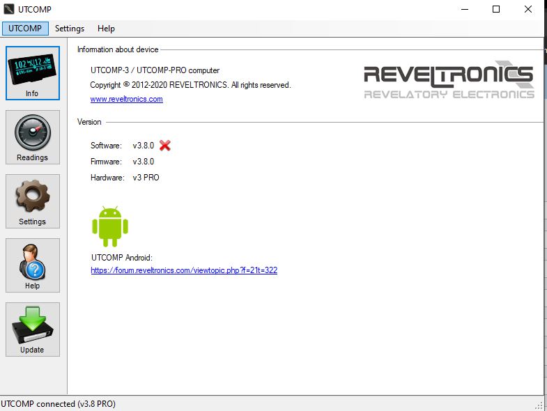

UTCOMP-3 have already 4+ years, you can try to reprogramm it, I can share you reprogramming software but please let me know which version exactly do you have.

Sorry, yes it is UTCOMP-PRO, sticker behind W-4993. SW & FW = v3.8.0

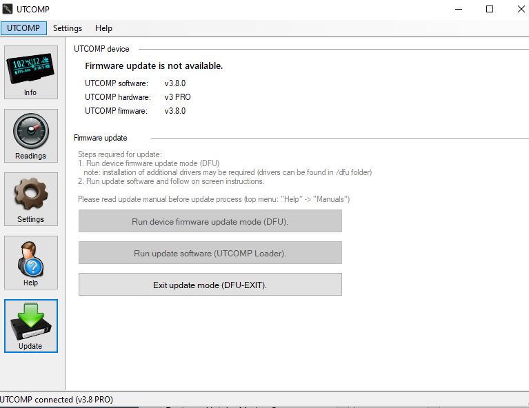

I've sent you on PM update tool so you can reprogram internal flash without sending device to us. Please reprogram it to latest version to check if strange behaviour is from corrupted firmware or from fault on hardware.

Thnx! Managed to make fw update successfully. Unfortunately buttons still not working... must be issue on board then? Is there any replacement parts or whole new unit?

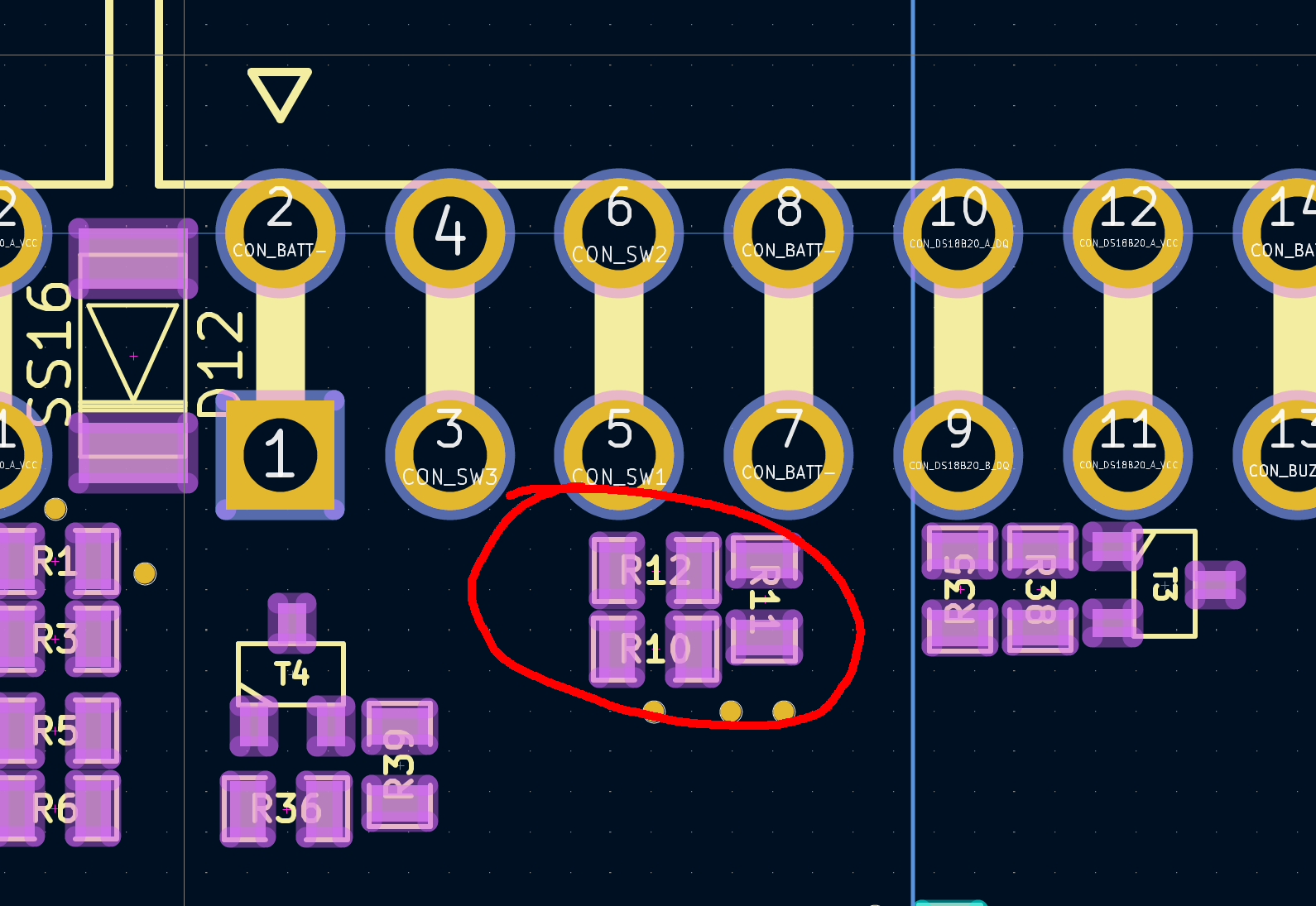

Switches are directly connected to MCU via 1k ohm resistors in series. Please check this resistors I marked on image below. If they are fine and connection is fine - I worry that faulty is MCU, can not be replaced by user. And the question is - what happened, because usually more than +5.5V on senstive pins may damage some ports.
