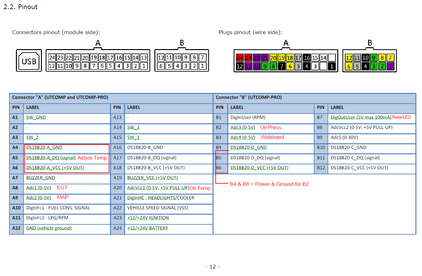

Enclosed a graphic which connection I would use.
Red = sensors
Green = occupied/used cable
Are my assumptions correct?

Timoes wrote:Enclosed a graphic which connection I would use.
Red = sensors
It's great :-)
If you will use stock oil pressure sensor (connected to B2/Adc3) then you will NOT need to connect B6 (+5V power) and B4 (ground) because it is already powered in vehicle. This is the case only for separate sensor wich should be powered.

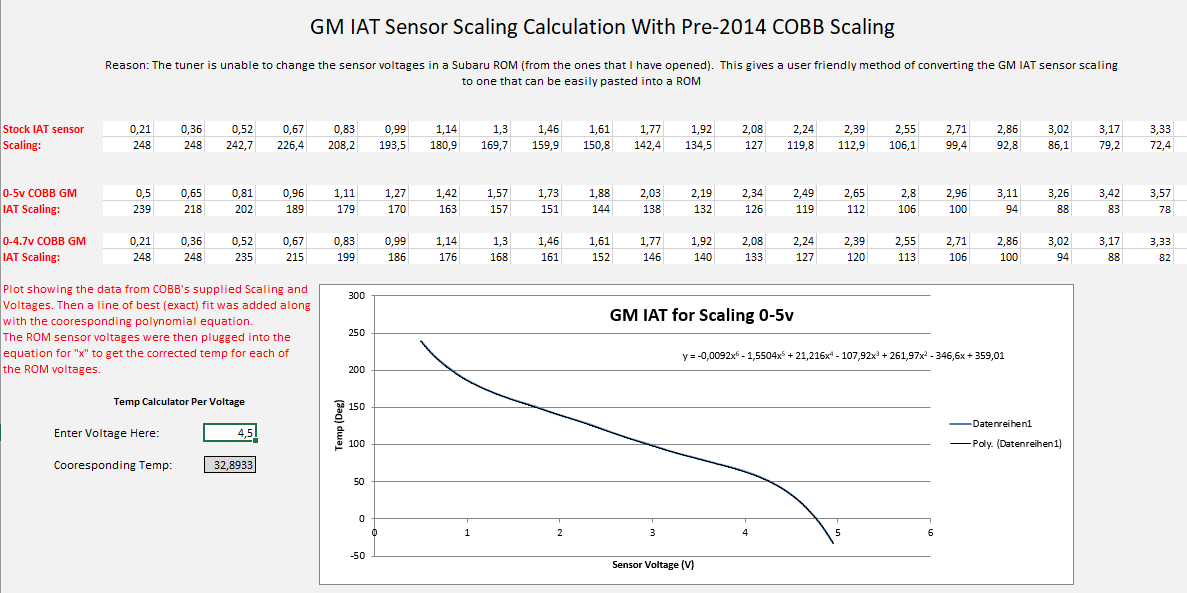

Also the tip that the DS18B20 reacts faster without isolation helps me a lot! Maybe I will add a second sensor (A16-A18) to the intake system near the engine.
But it has priority for me to be able to use the IAT sensor of the engine.
The IAT comes from GM (identical to AEM IAT). Unfortunately I haven't found any satisfactory values yet.
GM IAT and OmniPower MAP

Found out the GM IAT isn't linear.
So I plan to install a second DB in/near the intake manifold.

IAT is NTC sensor (99% sure) and you will need only calculate R25 (resistance in 25C) and Beta parameter. With above excel you can calculate it from 2 points of characterictis [ NTC(U) tab in excel ] so if you can measure voltage for 2 different temperatures then it should be enough for calibration.

Yes, I wanted to do the conversion to Bar. I have only set the raw data here, because I have not ordered my UTComp yet and have not tested the values yet. Thank you very much for your conversion.
So far I have unfortunately found different values for the IAT sensor.
Here are 2 examples:
I evaluate the IAT sensor against my ECU until I find a real formula.
Re: Need help selecting my components for UTCOMP (Pro)
Postby ArT » Sun Dec 16, 2018 12:45 pm
Hmm just try to measure voltage directly on sensor and you will see which one is correct.

Postby Timoes » Wed Jan 02, 2019 10:39 pm
The more time passes, the more I want to use UTComp Pro. But I am still preparing well.
EGT K-Type Amp:
On the IN site:
TC1 +/- to probe
GND & VCC to 12V board network? Fuse size?
Output site:
OUT1: Input A8 Adc1!
GND OUT: Where do I connect best? Unused B10 "Digital" GND?
In general, what to do with Ground if I want to use a 2 cable sensor?
Would also like to pick up the engine RPM. Found the signal on the ECU.
Difference between inputs: B1 DigInUser (RPM) or A11 DigInFc2 - LPG/RPM ??

Already found the answer to the EGT question in the forum. GND is not connected.
All I found for the sensors was the statement: Vehicle ground, i.e. A12 or together with it to the body.

EGT-K IN side:
TC+ TC- are thermocouples connections
VCC & GND is power supply for EGT-K amplifier (you can connect it to +12V ignition so it will drain current only when ignition is switched on)
EGT-K OUT side:
OUT1 - connect to AdcX in UTCOMP (Adc1 is fine)
GND out - you can left it floated (viewtopic.php?f=19&t=319)
Please take a look at datasheet (wiring schema at page 2):
https://www.dropbox.com/s/dqr1zv2bkg7wx ... n.pdf?dl=0
RPM:
Both inputs (B1 DigInUser and A11 DigInFc1) can be used for RPM impulse signal. It does not matter (what you prefere).
