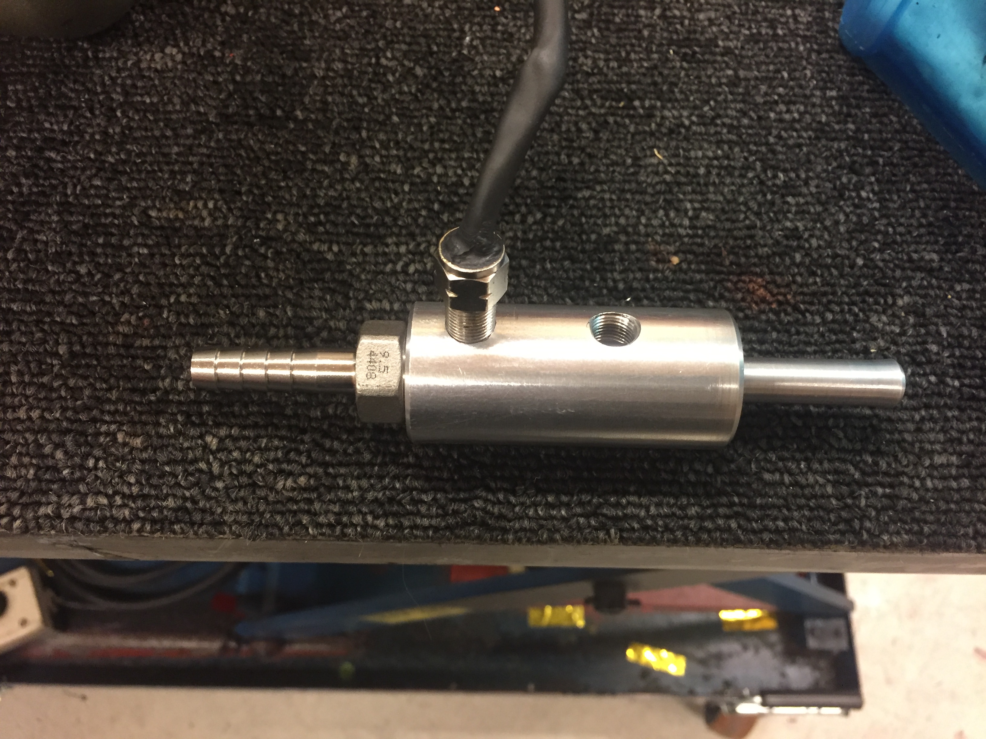

Postby svein » Mon Feb 18, 2019 12:32 am
I solved a lot of issues in the end by a combination of making a custom temp/fuel pressure fitting and getting a new filter before my lift pump. Both changes to the fuel system gave me less restrictions and now I have good readings of the fuel temperature as well:
