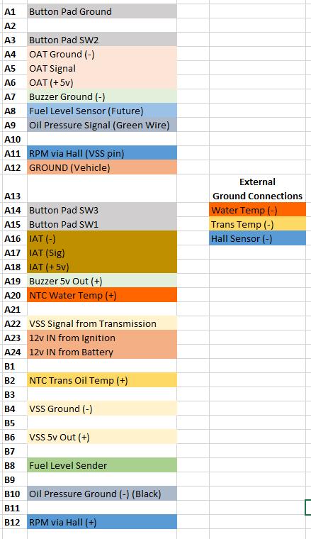

Here is my proposed wiring.
UTCOMP Pinout.jpg (62.84 KiB) Viewed 10076 times

Postby ArT » Wed Feb 06, 2019 10:47 am
One wire should be connected to Ground, and second wire to AdcVccX input (it will not work with AdcX input).
Wire colours does not matter (it is resistance sensor).

Postby DArtagnon » Wed Feb 06, 2019 4:31 pm
ArT wrote:One wire should be connected to Ground, and second wire to AdcVccX input (it will not work with AdcX input).
Thanks.
Help me understand something. The manual indicates that the AdcX inputs also support NTC type sensors. I presume then, that would be a 3-wire sensor that gets power from another source?
Re: NTC Temp Sensor Connections
Postby ArT » Fri Feb 08, 2019 12:15 pm
AdcX support NTC sensors which are already powered from ECU (with pullup) so you already have voltage signal which may be connected to AdcX input.
If NTC sensor is not connected then you have only resistance and it requires pullup to functional, so AdcVccX should be used.
AdcVccX inputs are with pullups to +5V (single wire for sensor power and measurement)
AdcX inputs are voltage inputs (without pullup, single wire is only for voltage measurement)
