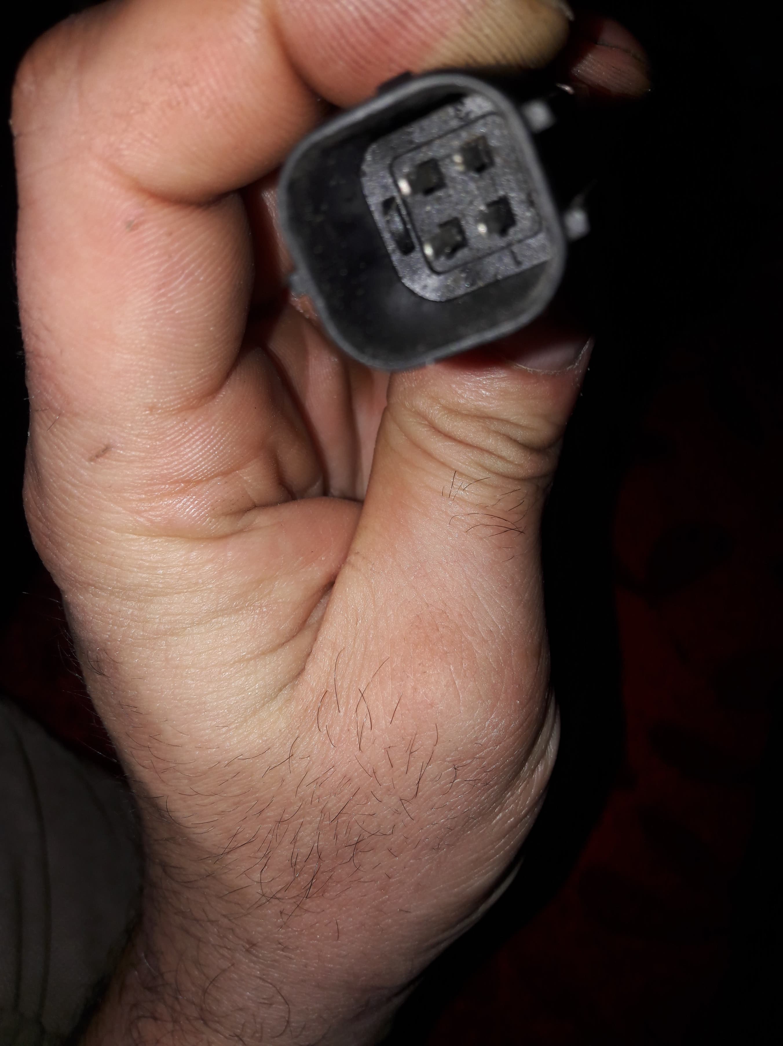

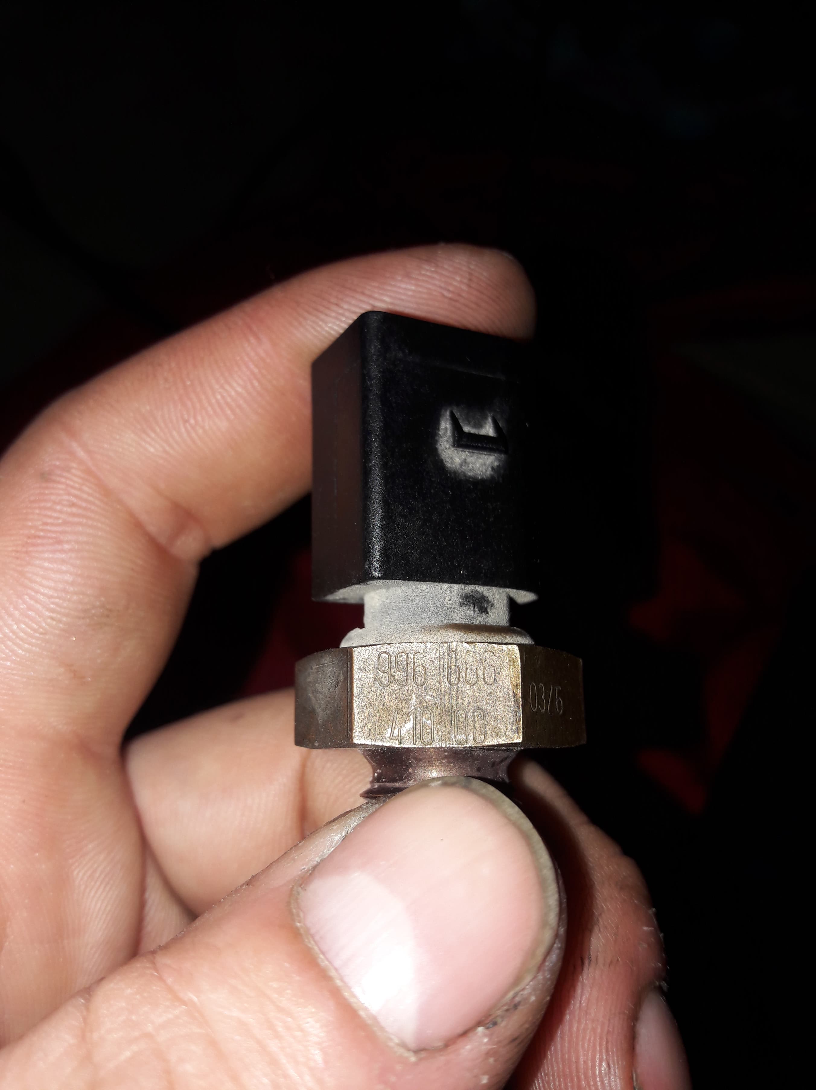

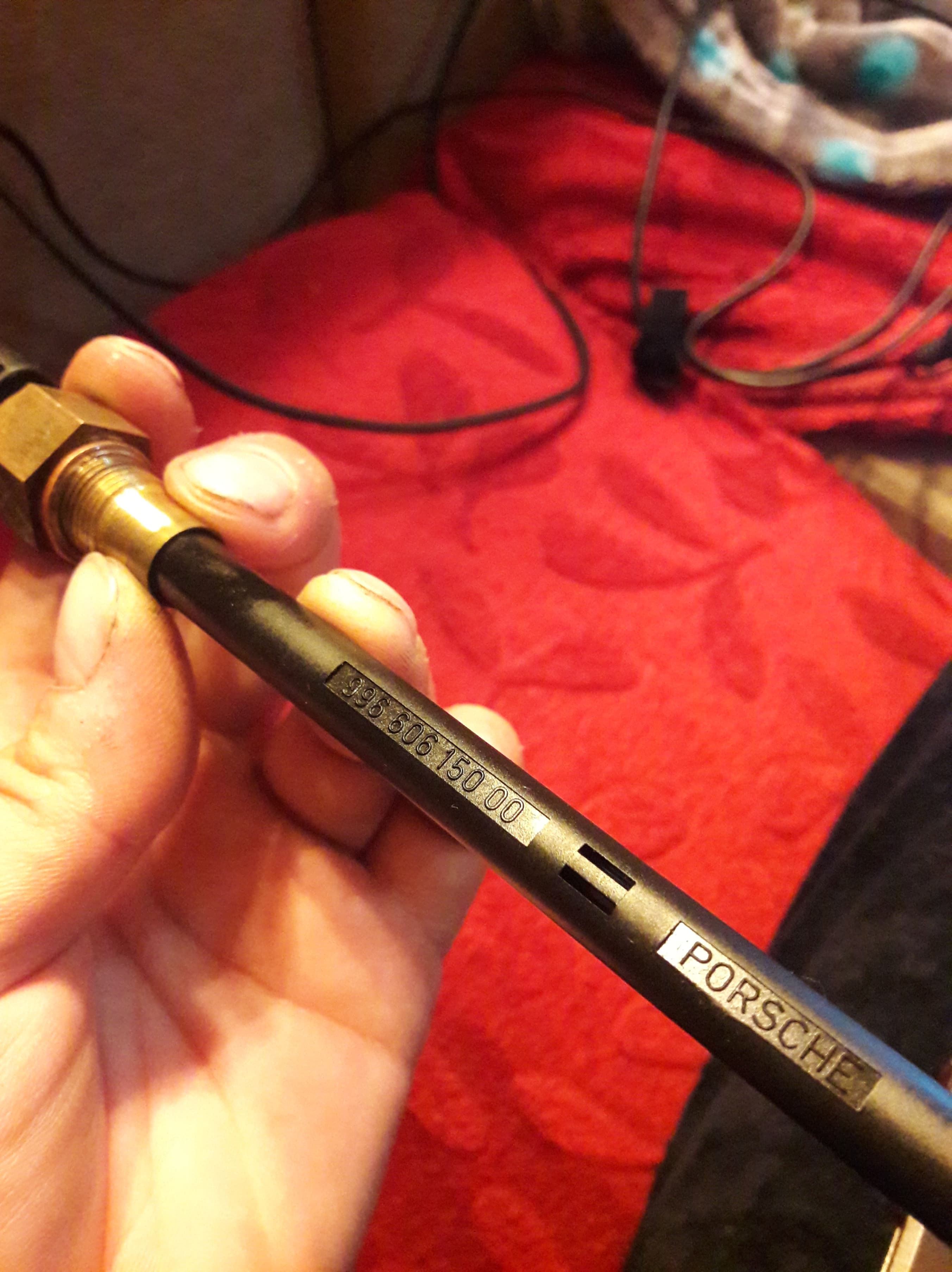

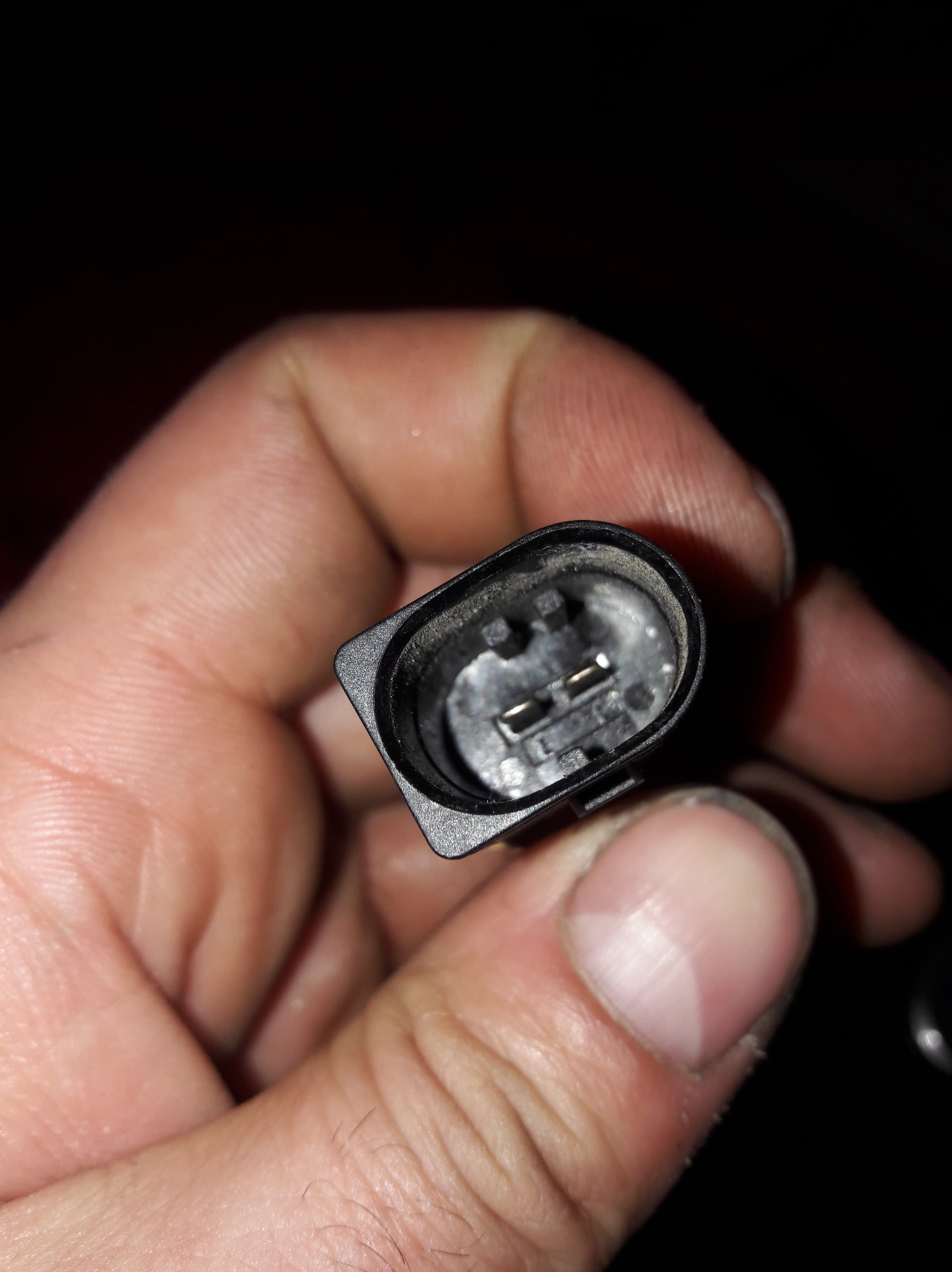

Hello i have a 996 carrera and i want to "steal" signal from the oem sensors for water and oil temp.. Is there any possibility doing that to confuse the signal going to ecu and have a false reading???? Also as i can undertand the oem sensors are analog ntc sensors and i have to calibrate them. Where i can found the values to do the proper table??? :? :? or how what i have to measure to find the values i am looking?? sensors are in the photos attached.. the oil sensor is a bit weird because it is oil level sensor in the same time...
oil
oil
99660641000 water
water

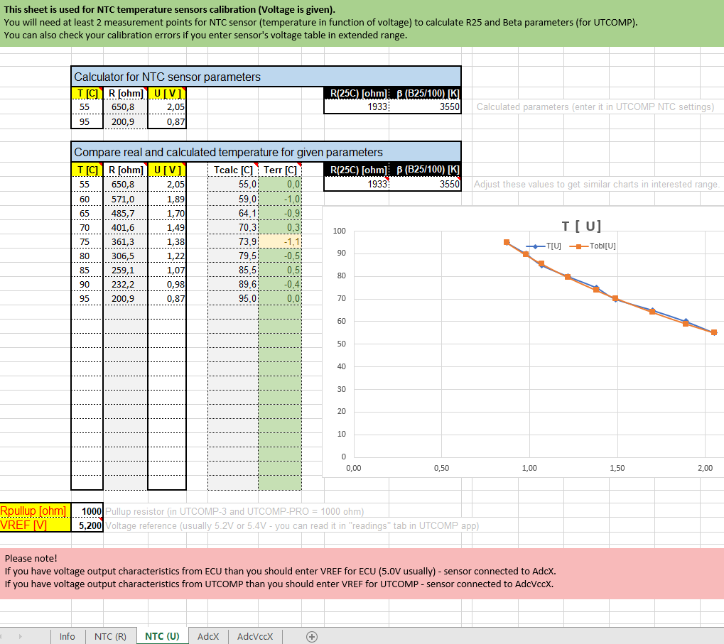

For the water temp i only need the voltage from the utcomp and the temp read from car ecu???
I took some voltage readings from 55 to 95 degrees every 5 degrees... i putted on the ecxel but didnt worked.. what should i do with the excel cells that i have no values like 120-130-140 20-30-40 ??
Re: porsche 996 piggypag sensors
Postby ArT » Thu Mar 05, 2020 7:06 am
For water temp you only need voltage and temperature. Does it show correctly for 55-95C range?
Please share me your voltage/temperature table or excel and I'll check calculations.

Nop i have readinga from 176 celcius to 234 something... these are the numbers
55c 2.05v
60c 1.89v
65c 1.7v
70c 1.49v
75c 1.38v
80c 1.22v
85c 1.07v
90c 0.98v
95c 0.87v
Postby ArT » Fri Mar 06, 2020 7:31 am
Have you did exactly as in screen? (R25=1933 Beta=3550)
markos
Joined: Fri Feb 14, 2020 10:24 pm
Postby markos » Fri Mar 06, 2020 9:21 am
Perfect now its working
