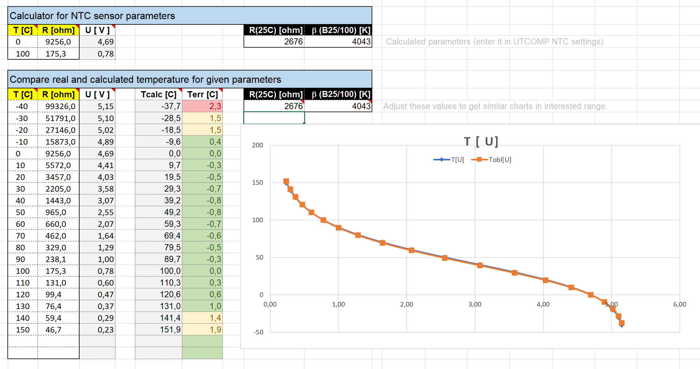

I have one air intake temperature sensor from my supercharger.
I think i can use it with adcvcc input for NTC sensor.
I have the datasheet of this sensor, i attach it.
Can you confirm if i can do it please?

Yes it will work, I checked and scaled it, please take a look attachment.
It should be connected to AdcVccX.
R25 = 2676
Beta = 4043

Perfect work!
Thank you very much ;)
