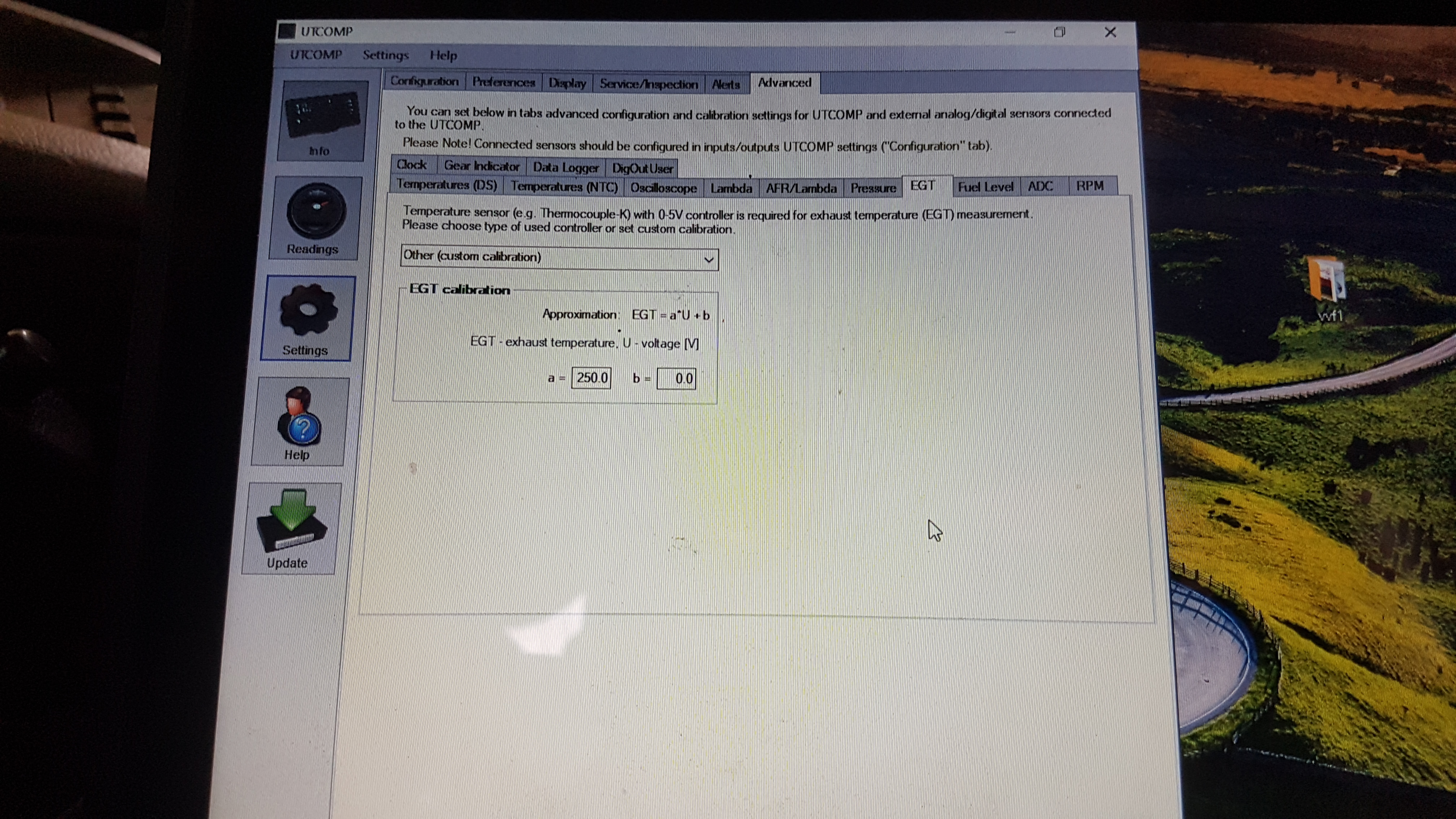

I have troubles with calibrating my EGTs.
I entered a=250.0 and b=0.0
Egt reading on Adc1 is 1.44Volts ( moving from 1.43v to 1.45v) and screening 357°c to 363°c , engine is off and cold.
What do you guys think?
Thank you

You need to check if issue with amplifier or with sensor.
Please disconnect sensor (from TC+ and TC-) and amplifier should give around +5V on output (UTCOMP should show around +1250C). Please confirm that you have +5V output on disconnected thermocouple.
Please make sure also that you have connected properly TC+ and TC- , if you swap inputs you will have similar effect.

Hi Art, and thank you for your help .
Indeed when wsapping Tc+ and Tc- ,the value remain exactly the same, and thermocoupler disconected also. It seems that my amplifier is bugged. It is a cheap Ad8495 ship .
I guess Im good for ordering something more descent.
