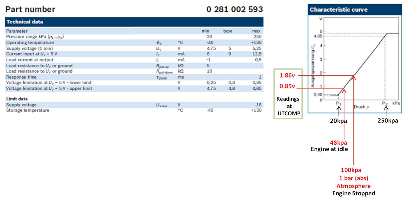

Could you check what voltage level is on MAP signal when you have -0,8bar or 1,5bar? I think these values from datasheet may be not correct. And do you mean -0,8bar where reference point is atmospheric pressure? Which value was atmospheric pressure, 1,0 bar or lower? We need absolute pressure for scaling, not relative.
You cna also check your readings from ECU and scale using these values, e.g. when your ecu shows 48kpa (absolute) what voltage do you have on MAP signal? You will also need second value for scaling (sensor is linear)

The voltage in the UTCOMP readings are 1.86v at atmosphere, engine off (1bar absolute) and 0.85v at 48kpa absolute with the engine running at idle. I have enclosed the data sheet for this MAP sensor.The sensor will output 4.65v at 250kpa absolute (150kpa,1.5bar relative to atmosphere). I did check the sensor with vac and pressure when I calibrated it for the ECU, and the figures are correct to the datasheet. The voltages the UTCOMP is reading are correct for the pressure/vac at the engine. With the engine off the display shows a correct figure of 0 psi (atmosphere). With the engine at idle the display shows 7 or 8 psi. If this figure was shown as -8psi it would probably be correct. Is this the problem ?. Will the display not show a minus ?.
Ideally I would like the display to read 0 psi for all situations that do not produce boost (positive pressure), but if I have to have a negative psi for vac that will be ok.
