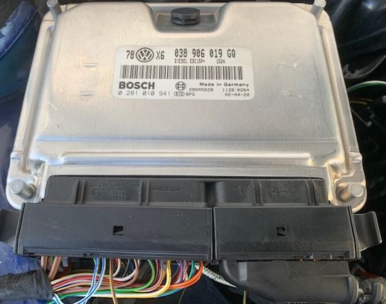

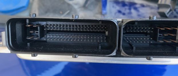

Re: Fuel consumption signal
Postby ArT » Mon Sep 27, 2021 7:57 am
Did you have white-blue on pin 20? or only at pin 21?
Please send me your ECU picture (connectors) before testing it on pin21.
Please note also that you should set PWM (+) control signal in settings - otherwise it will not work.

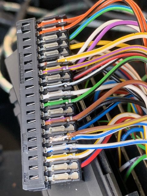

gtbtdi
Posts: 9
Joined: Fri Sep 24, 2021 11:51 am
Postby gtbtdi » Mon Sep 27, 2021 12:58 pm
I connected wire only to the pin 20. Utcomp is set for PWM(-).
I noticed that utcomp shows readings while car is moving, but I think they are not consumption related. For example rolling downhill with gear on, instrument cluster goes to zero while utcomp is showing readings.
When I stop utcomp display goes to zero.
Brown-Yellow goes to the utcomp pin A10
Postby ArT » Mon Sep 27, 2021 1:19 pm
It seems that pin 20 is programmed to speed signal in this ECU.
Please check PIN 28 - it should be yellow wire.
And please set PWM+ in settings.
