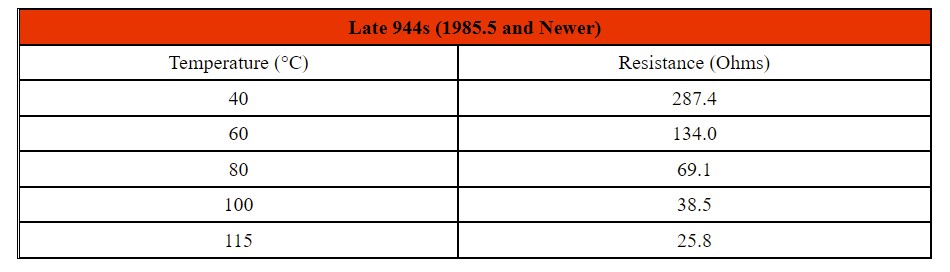

I got the following information:
Skjermbilde 2022-07-23 135745.jpg (39.75 KiB) Viewed 7511 times
A quick measurement with ignition off, between A8 and ground confirms these values to be correct.

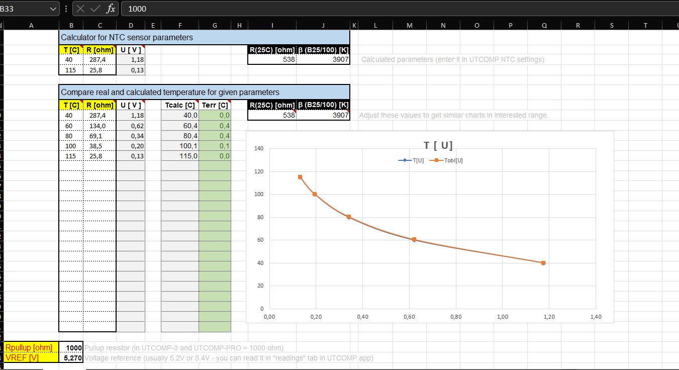

So i tried to enter the previous values into the calculator
Skjermbilde 2022-07-23 135631.jpg (202.03 KiB) Viewed 7511 times
as you can see this wont work, as the voltage values are way off..
Am i missing something here?
For "fun" i tried to just use some random value at R25, and at 9000 / beta 3907 i am getting around 90C at the ucomp.
So the sensor works, from cold to warm engine the temp at ucomp increases, oem gauge still works fine.
However it would be nice to find out what i am doing wrong, if it would be possible to calibrate this with the provided values for the oem sensor?

If this is OEM sensor (which is still connected to stock installation) you can not calibrate it using resistance - you will need to measure voltage and use NTC(U) sheet for calibration. The reason is that stock circuit is converting already from resistance to voltage. Please prepare temperature/voltage table and we will calibrate it together. Voltage should be in range 0-5V to make it working.
