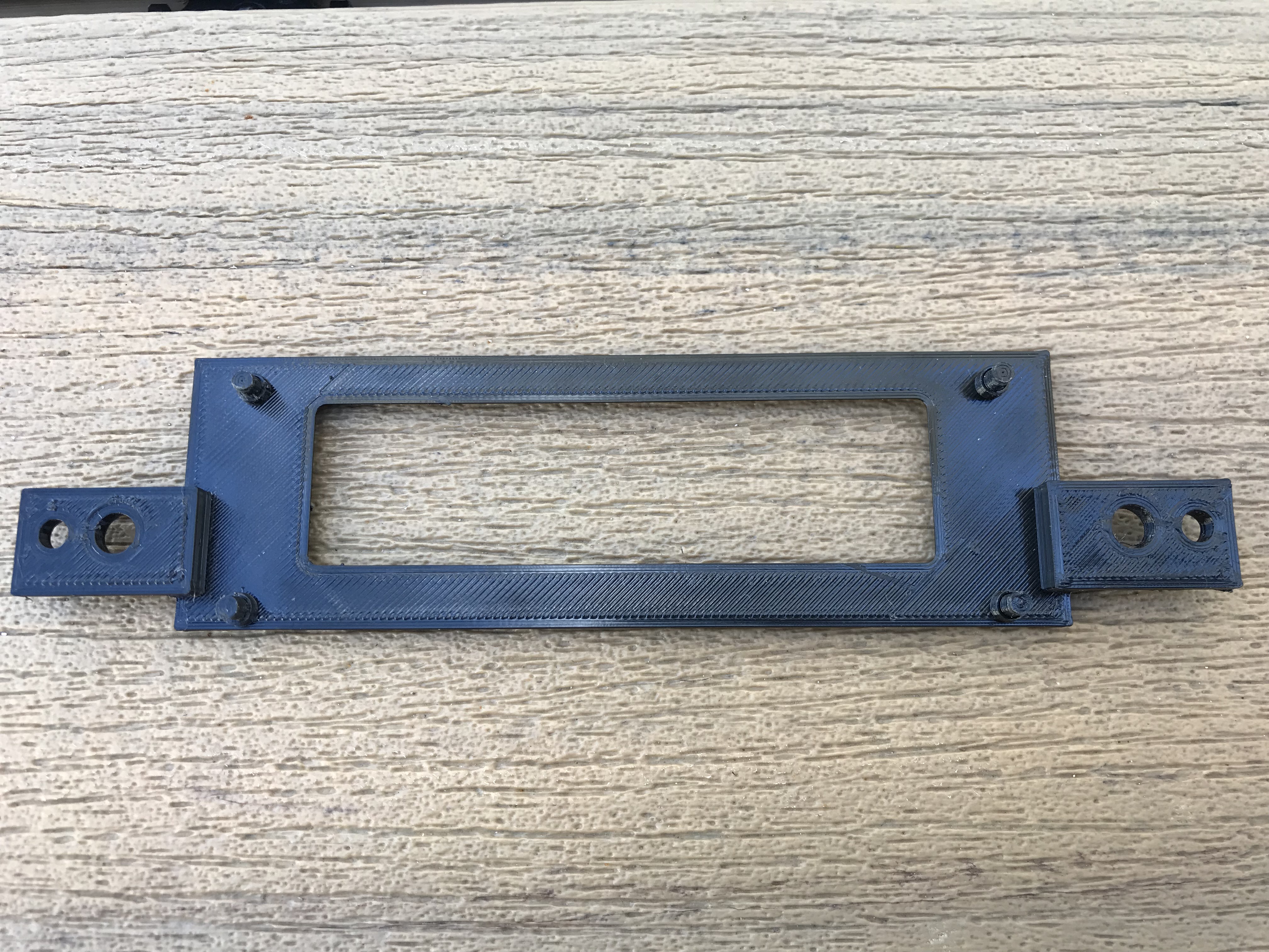

I designed an adapter bezel so the screen installs into the original clock location. For other CRX owners, the original housing must be modified a little for clearance in order for the screen to be centered. You could also shift the window opening and mounting tabs to avoid this but the screen would be a little off center vertically. I attached the screen to the bezel by putting a tiny dab of epoxy on each of the 4 posts, not much at all. I also sanded and cleaned up the print to make it look less like the typical 3d printed texture. Thank you Art for answering all my questions and producing this awesome product. I will put a link here to the STL file for the bezel.
https://www.thingiverse.com/thing:5516812
