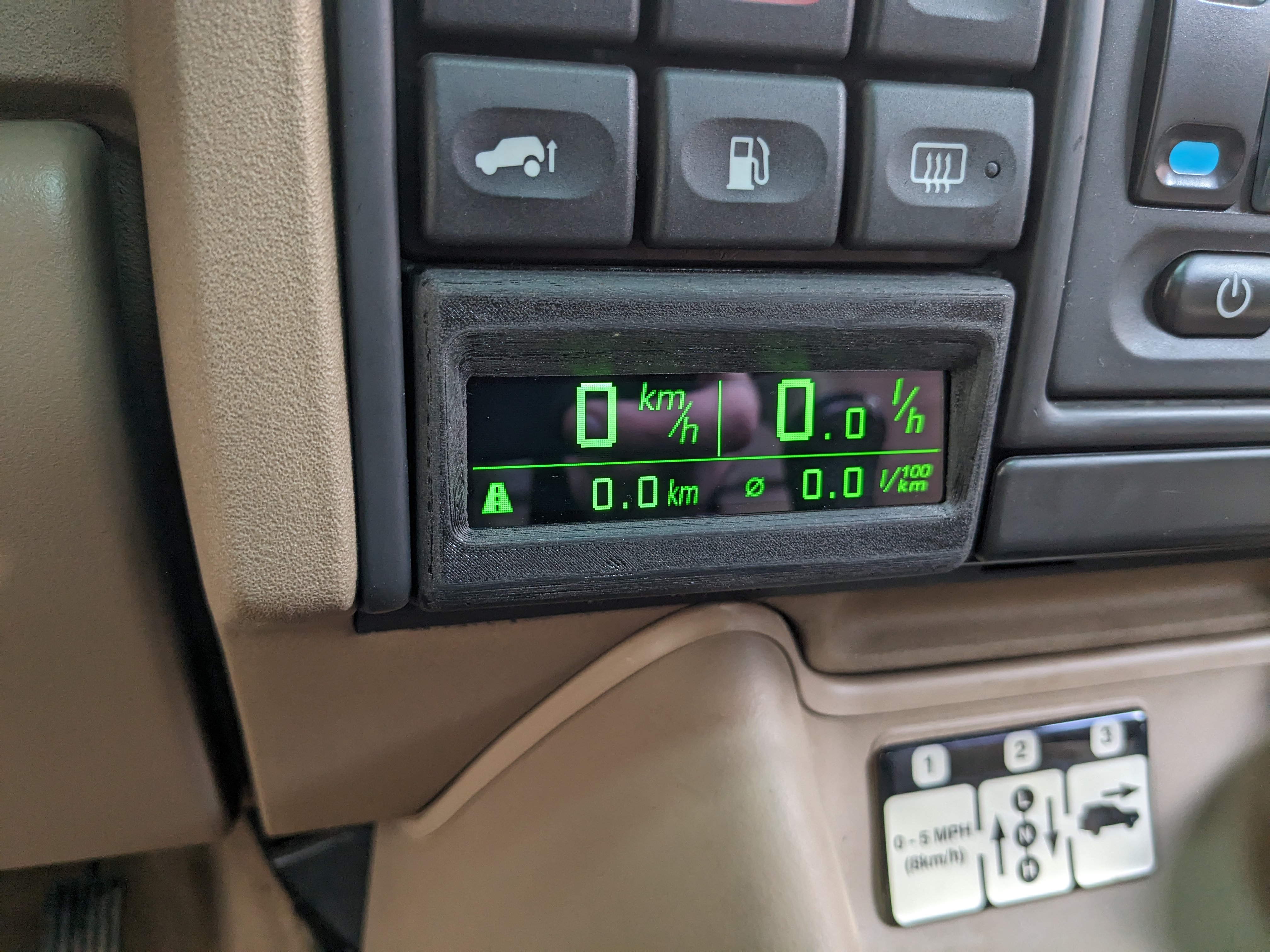

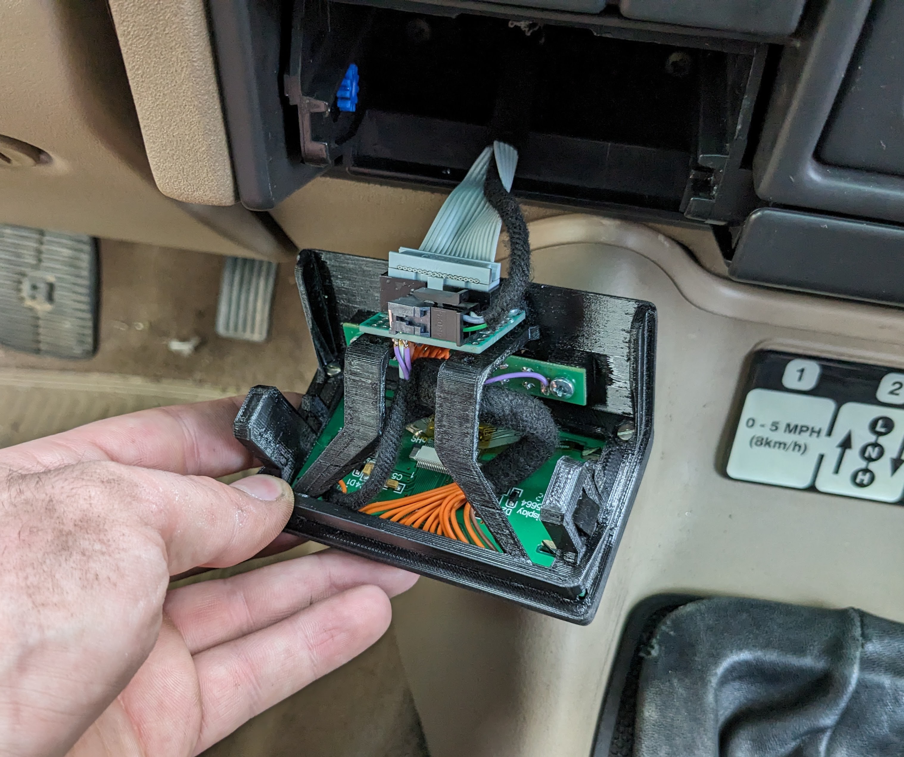

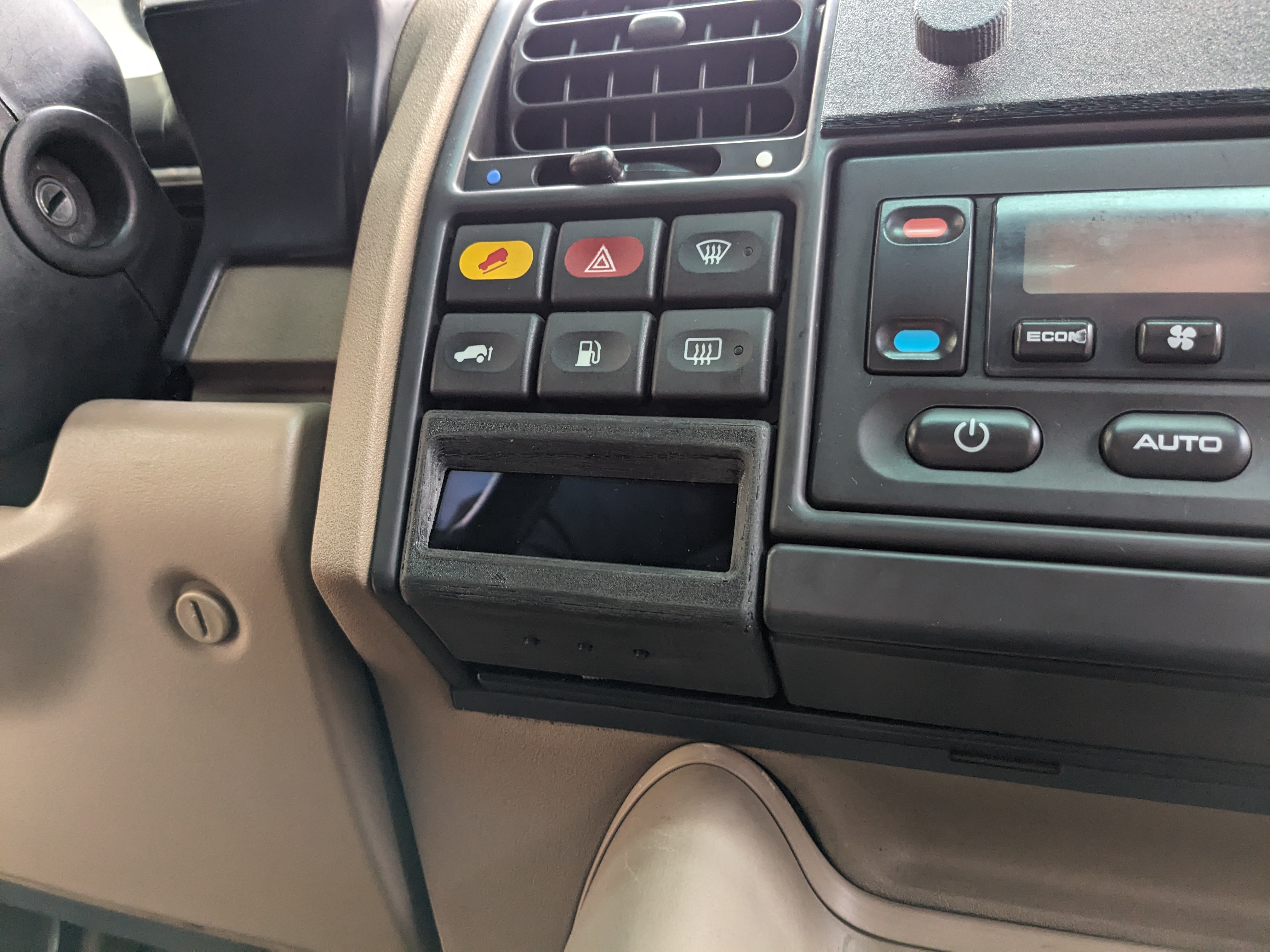

Because I hate any drilling or cutting dash, I created and printed holder for OLED board from Newhaven as replacement of ash tray. Newhaven make displays with narrow PCB and so can it fit inside LR dash. More info related to connection here: https://forum.reveltronics.com/viewtopic.php?f=19&t=1121
OLED holder have nice "click" snug fit.
3D model is downloadable here: https://www.printables.com/model/790947-land-rover-discovery-2-oled-holder

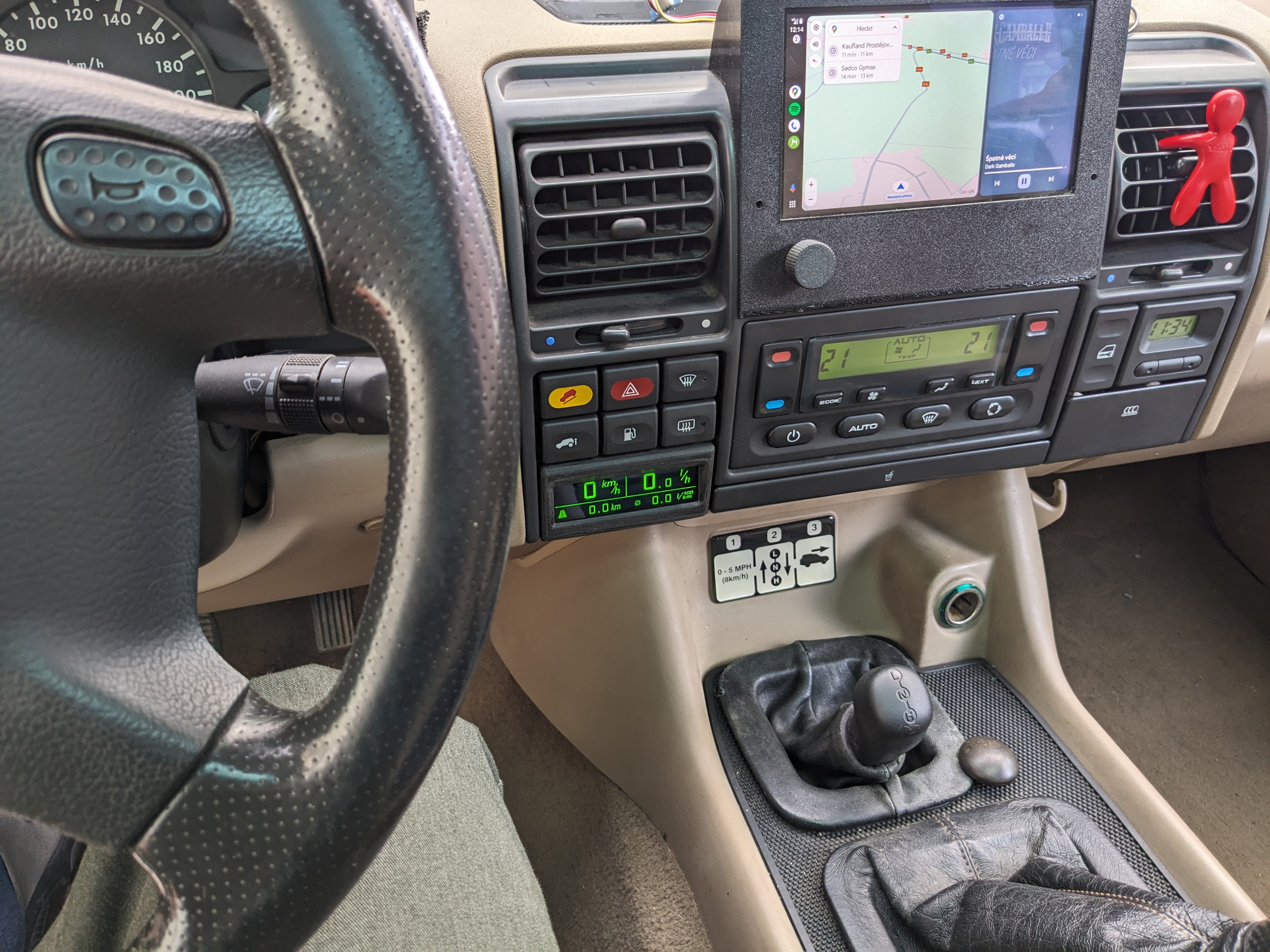

From driver point of view:
