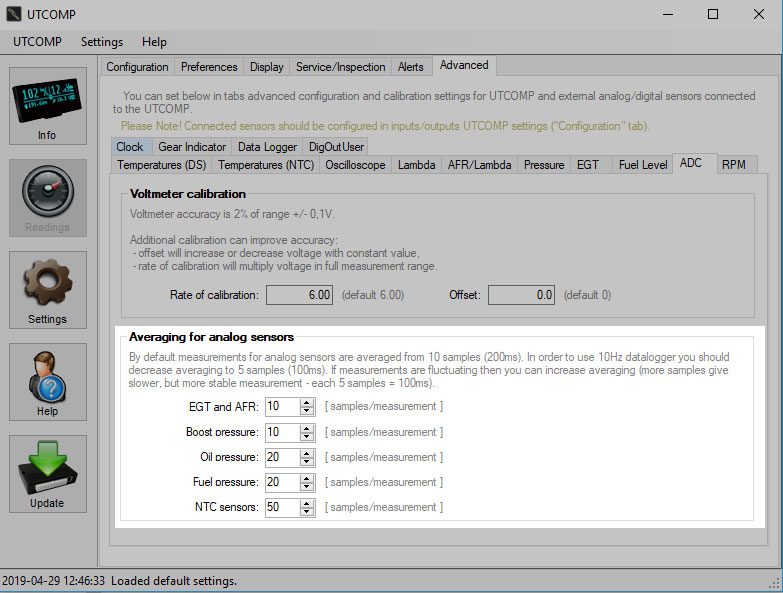

- added settings for analog inputs averaging (it can be customized to make measurements faster or more stable):

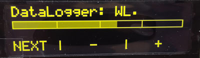

- added manual data-logger (logging can be enabled or disabled from menu) with current memory state:

Thanks. I installed 3.7.1 and greatly appreciate the ability to slow down my temperature readings.
