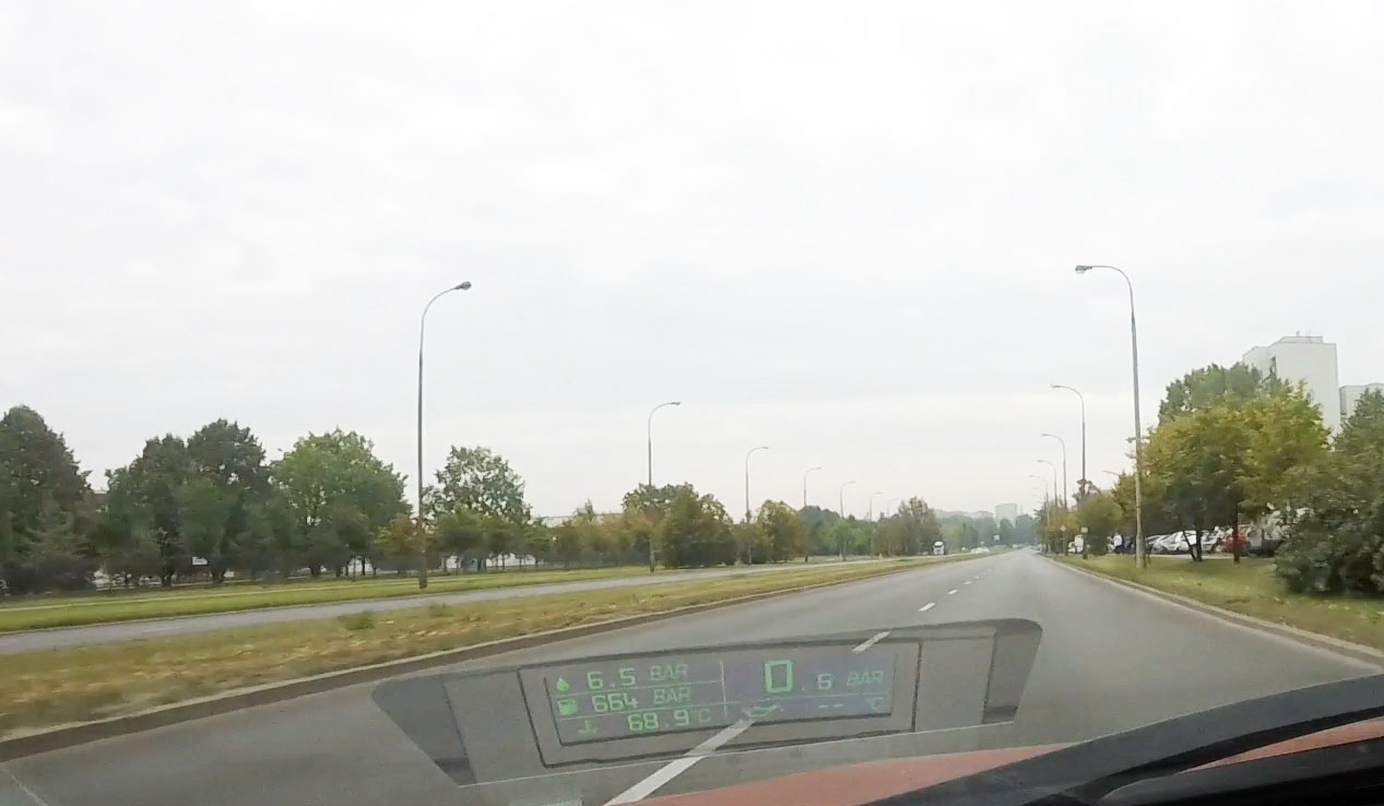

HUD mode for OLED in UTCOMP-PRO
At the end small gadget feature :mrgreen: Added Head-Up Display (HUD) mode for OLED in UTCOMP-PRO. In this mode all data are displayed in mirror on the screen. You can use windshield or dedicated small piece of glass for reflection. There is HUD foil recommended to get better visibility. Visibility in day-light is.. not so good :cry: but in night... take a look:
If you would like to use HUD as regular mode, I recommend to use dual display (one in HUD mode and second traditional in dashboard - you will need 2 modules) or use separate small piece of glass with HUD foil.

Sweet!!!! Cannot wait to try out the upgrade! When you say "Dual Display requires 2 modules" do you mean two display modules or two UTCOMP modules?
How can you connect two displays?
Re: Update v3.4 for UTCOMP-3 and UTCOMP-PRO
Postby ArT » Wed Oct 05, 2016 4:38 pm
2 modules + 2 displays.
You can connect 2 displays parallel to single module but both will be in normal or both in HUD mode (both will be displaying the same), so you will need 2 UTCOMP-PRO modules (you can connect most signals parallel to both modules with shared keyboard) and one will be in normal mode and second in HUD.
Eventually if you learn your brain to read mirrored values than you can stay with single module :mrgreen:
Personally I'm using HUD mode over 2 weeks now and it's fine in most cases - with HUD foil it is readable in daylight. The only "bad case" is sunlight in front of you operating directly on display - in this case I can not see any data :( I can make photos under different conditions if you are interested.

ArT wrote: The only "bad case" is sunlight in front of you operating directly on display - in this case I can not see any data :( I can make photos under different conditions if you are interested.
I'd like to see those photos. I see that you use green oled display. Do you have access to another oled display (white, blue-cyan, amber). Maybe another colors will be more visible in hud mode? Could you make test/photos with different colors oled display?
