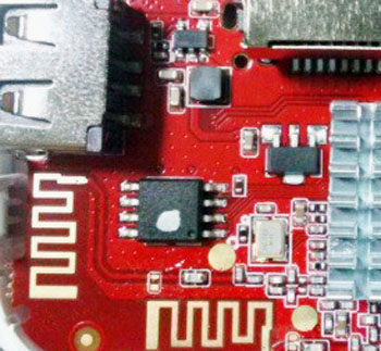

hello, I need to repair firmware in NEXX WT3020h mini router and need programmer for serial flash:
NEXX WT3020H EN25Q64 flash.jpg (70.43 KiB) Viewed 4428 times
this is probably EN25Q64 but I found on forum that it can be also W25Q64 or W25Q128..
does revelprog support all these chips??
Re: EN25Q64 programmer for NEXX router WT3020H
Postby ArT » Tue Apr 03, 2018 7:52 am
All these chips are supported in all variants (e.g. EN25Q64, W25Q64BV, W25Q128FV etc.) by REVELPROG-IS. Generally if you know that it is 64Mbit 3V flash then you do not need to know exact symbol because REVELPROG-IS has "smart" procedures for programming (it is enough when you select FLASH -> 25 series -> 25..64 for any 64Mbit flash), but you can also use "Read ID" function to identify the chip (so you will see if it is 128Mbit variant on not). I see on picture it is SOIC-8 208mil package, so you will need adapter for this chip (SOIC-8 200mil) or SOIC clip for icsp.
nexx
Joined: Mon Apr 02, 2018 7:31 pm
Postby nexx » Tue Apr 10, 2018 9:44 pm
hi Art. I received programmer. it arrived very quickly. it was w25q64fv. I reprogrammed it without problems... thank you for great support! I'll recommend revelprog to my friends because it is simple in use and quality is good.
