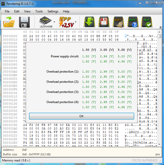

hardware test.png (112.88 KiB) Viewed 11588 times

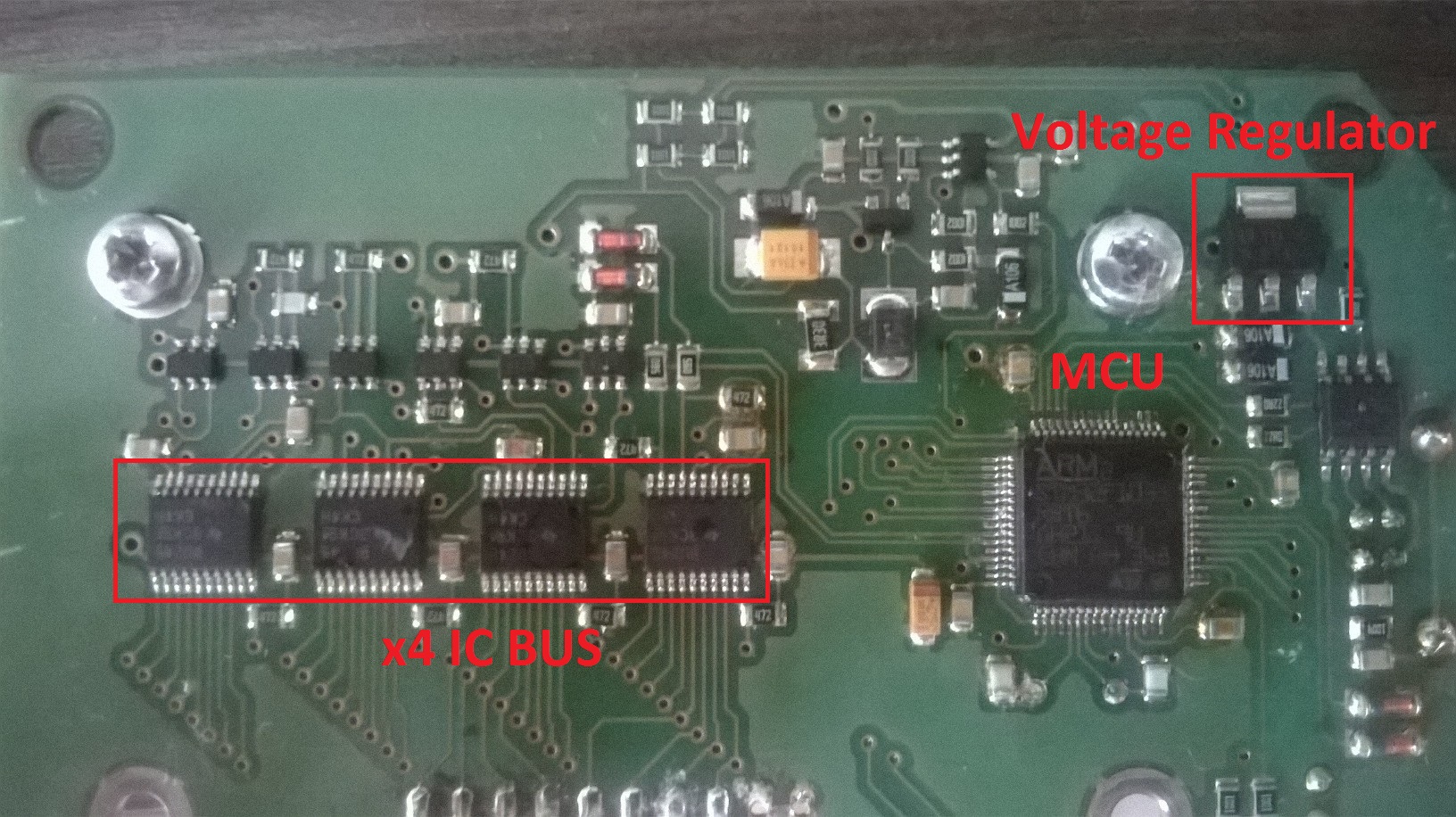

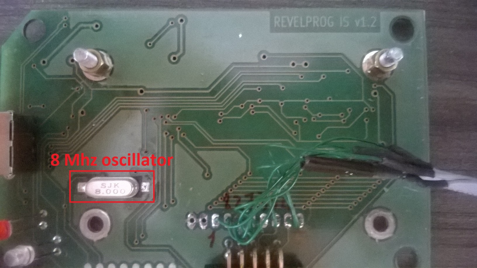

I did resoldered MCU (IC STM32F103RBT6), the four bus chips and the voltage regulator with my hot air soldering station and the help of Amtech flux, but this didn't help me. I also changed the 8Mhz quartz oscillator, my programmer still behavies the same (few bytes still not readden properly, testing on SPI 25X40AL chip at the moment).
Finally, i discovered that when i use refrigerant spray on MCU, i get nice good reading for a while, this means that MCU is faulty.
I'm considering to change MCU chip, i can do by myself, but i need to program MCU chip via JTAG.

It seems to me that something is with MCU - have you checked it with lower speed? (settings -> hardware -> flash spi SCK = 10%)
HW test at 5V gives 0.04V difference on buffer - it seems that voltage drop is to high due to high current consumption (in idle).
It may be also something with filtering capacitors - I see that you have one of the earliest hw version and after few years they may have different parameters. You can try to remove capacitor. I marked on photo with yellow (it is few pF and is very crucial for high speed SPI transmission, but in latest versions there is software filtering and it can be removed).
We can check it, and if MCU is faulty we will replace it free of charge.

The crucial for FLASH SPI is capacitor I marked at the photo above (it is on SCK line), it is few pF (4,7pF - 10pF as I remember) but you can remove it and it should work 100% fine with latest software without this capacitor.

You can try to remove capacitor I marked on photo with yellow (it is few pF and is very crucial for high speed SPI transmission, but in latest versions there is software filtering and it can be removed).
Ohh sorry, i just see it.
Hmm, i don't think so it's that capacitor the problem, because it reads good when MCU is very cold (when i spray refrigirator can on mcu)
When capacity changed (aging) then SCK high speed switching signal states may be not recognized properly with MCU (when you changing MCU temperature then lo/hi levels threshold are changing too) - I had similar issue before with old unit. You can check it before shipping, but it may be also MCU faulty.

I removed that capacitor, now it is reading always good :D
