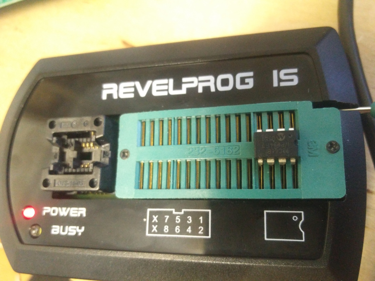

chip insertion
Re: 93C66B - APC SYBT5 checksum changes on read
Postby ArT » Sun Mar 10, 2019 7:42 pm
2 voltages for 5V rail looks low, could you make hardware test again and click "CTRL + 1"? It should display more measurements. Please make screenshot we will see. Maybe programmer is damaged.
