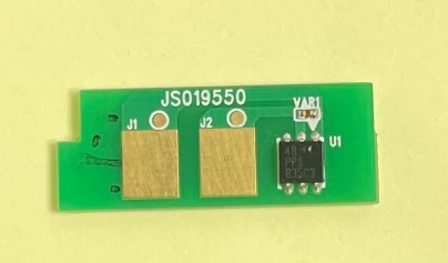

Postby Janusz4691 » Thu Dec 02, 2021 4:44 pm
help with chip type identification : 48 + PPS 835C3
Please help me identify chip type

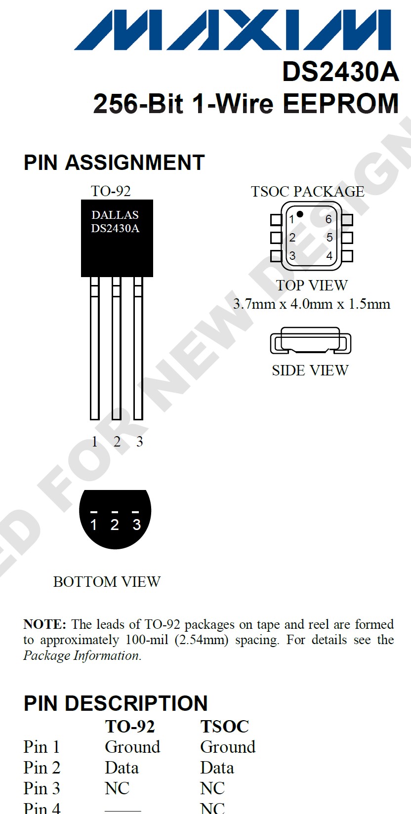

Postby ArT » Fri Dec 03, 2021 9:10 am
Looks like something from DS24xx series in TSOC package, pin 1 is ground and pin 2 is data line, maybe DS2430, DS2431, DS2434 or other, but this designation 835C3 nothing tells me :(
