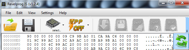

After reading file can i swap from 16 bit to 8 bit, without having to read the device again ?
Re: file swap function (swap-bytes) in REVELPROG app
Postby ArT » Wed Apr 15, 2015 9:37 am
Yes you have swap byte function in menu:
But sometimes if chip is 8bit (and does not support 16bit) and you read it as16 bit than you read only half of memory and swap will not help.
