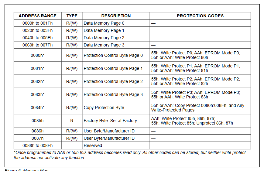

Here you have datasheet:
https://www.analog.com/media/en/technic ... DS2431.pdf
Memory is organized to 4 pages each 256bits and each page can be permanently Write Protected. You can read control bytes using custom script tool from addresses >=0x80 as described in datasheet page 7/27

Ok, so we have:
4 protection control bytes
1 copy protection byte
1 factory byte
2 user bytes
= 8 bytes in total
First five bytes If programmed to AAh or 55h, it can not be erased. Factory bytes are read-only, so they are definitely not erasable, but 2x user bytes are erased and rewritten all day.

It does not change any bytes in this register. After programming standard eeprom area, control bytes stays the same. You need to change them intentionally e.g. with custom script.
Many chips have some configuration or protection bytes which are not accessed in standard usable range addresses.

Now, I'm talking very specifically about the programmer device and its app. If I write on a brand new DS2431 chip, will it write-protect it by default at address 0080h* to 0084h*?
Basically, what I'm asking is what is the difference between writing and reading via app UI functions, and customs scripts mentioned?
Regards
Re: DS2431 erasing issue
Postby ArT » Wed Feb 21, 2024 10:15 am
When you select DS2431 from memory database you can read/write standard memory area (0x00 - 0x7F) - data memory page 0,1,2 and 3. Additional registers (0x80 - 0x8F) are untouched.
With custom script tool you can do anything. You can read/write single bytes at specific addr, you can modify additional registers, you can use it for automation etc. You can also make standard read (0x00 - 0x7F) and results will be the same as when you select DS2431 from database.
