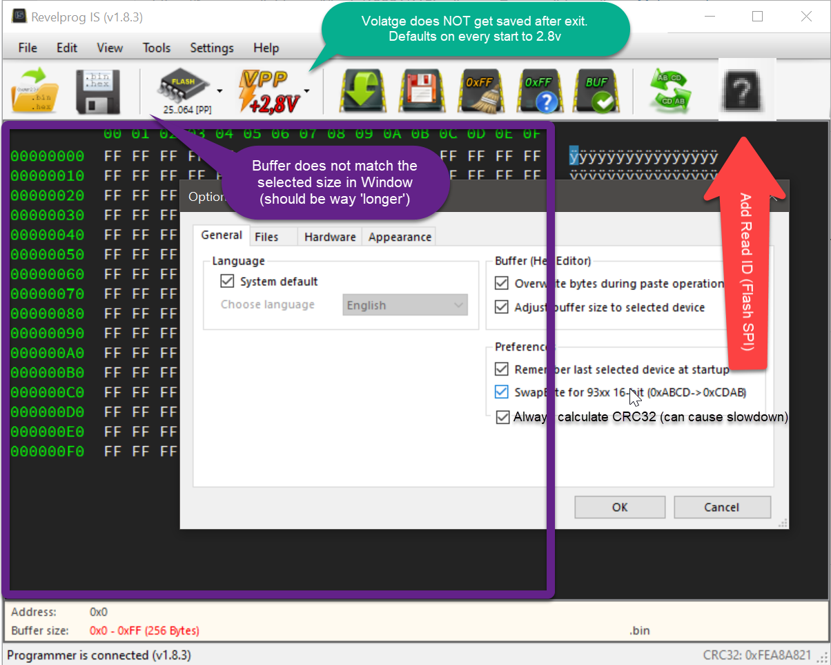

Hey ArT. Thanks for the clarification and offer for custom software with automatic CRC.
From my perspective many things can be improved and most of them are just very minor. Let me know if you think it makes sense to write things up or create more mockups.
Just to clairy my intensions visually I made some mockups.

Thanks for the goodwill in adding/changing stuff.

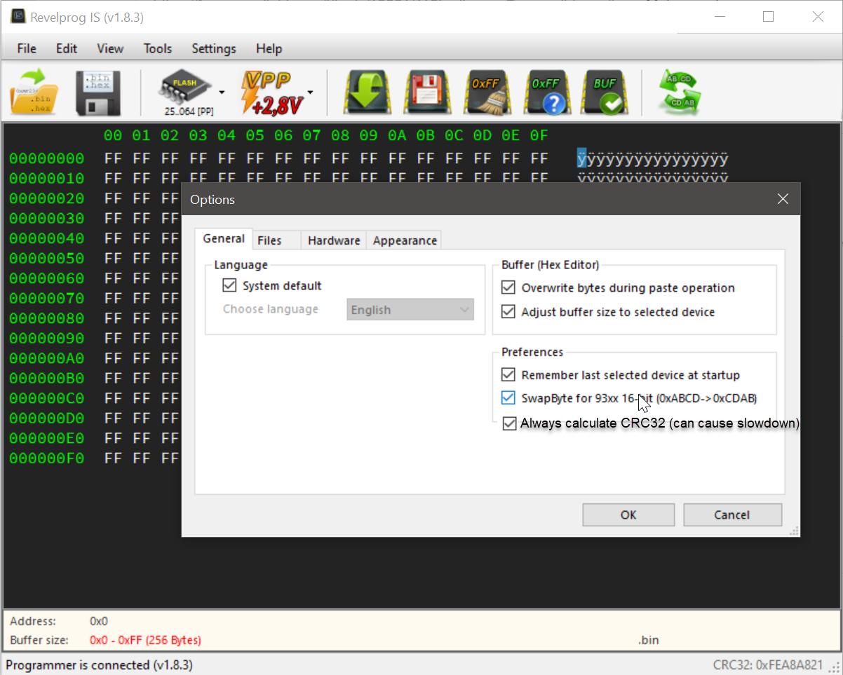

CRC works fine now but could be improved in two ways:
- Use black as color in the statusbar
- Disable the calculate pop-up message if the checkbox is selected (or make this an option)
I understand the problem about missing information in the Database. From my POV implementing something Read and Select (Autoselect) (like many programmers do) would be still a must have feature and a lack of database should not stop the implementation in this topic. The Database might not be big yet but can grow over time and (more important) a working implementation with known chips is better than none. It would be still better to have some auto select that uses "generic" like "25 064 [PP}" description (may as a fallback if it can not exactly identitied) than like currently none.

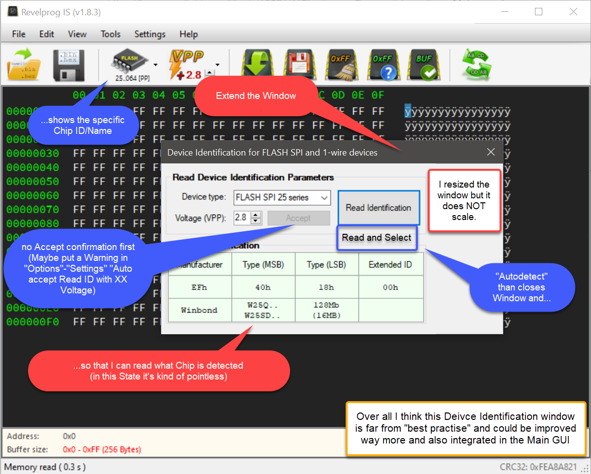

As shown in the Mookup/Screenshot the readout from "Read ID" is pointless if I can't read the sting/info/name of the chip if the field is just to small. This can be fixed very easily. Some shortcut for Read ID would also be nice. (Maybe Ctrl+I)

The field read ID is not to small - these dots (e.g. W25Q.. and W25SD..) are intended. The family was identified and the size was identified (128Mb). So you know that you can use FLASH -> 25series -> 25..128 [PP] universal procedure but you still do not know voltage. The problem is that W25Q... and W25SD... have the same ID for family, but different voltage. There is no way to identify it based on read ID. It can be identified only by signature on package or by measuring voltage in circuit. In latest devices there is also SPDR register with additional information about device. I agree that working implementation with known chips is better than none. I can't promise but I think that we can try to add such feature - at the beginning only for few chips and we will see.

Please check this proposition: https://youtu.be/Fb70E-Xq_fk
Accept button is improved, but it can not be removed (safety reasons and hint with connection diagram). Now when you click accept once, you do not need to click it every time, it's remembered until you change device series or device voltage. Clicking Read ID will close window if chip is fully detected. You can restore window by clicking Read ID icon or F10. Please let me know what you think.
