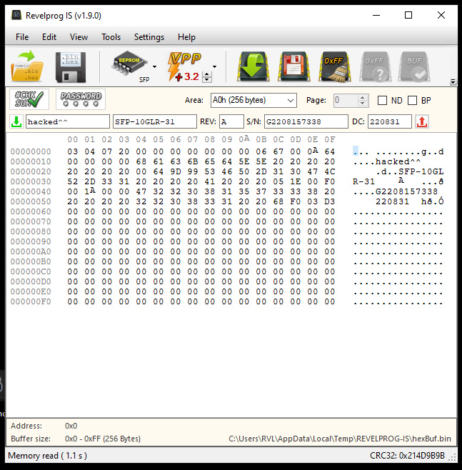

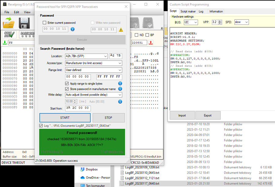

Ha, sucess. I ordered generic type of FS LR (SFP-10GLR-31). After 10+ days of brute forcing I found manufacturer password for it, check screenshot below. Everything is working with this password, I can change manufacturer name, s/n etc.
Just ignore start range - my PC updated and restarted during brute forcing. But I had logs so I could restart the process where it ended.
thankfly

ArT wrote:Ha, sucess. I ordered generic type of FS LR (SFP-10GLR-31). After 10+ days of brute forcing I found manufacturer password for it, check screenshot below. Everything is working with this password, I can change manufacturer name, s/n etc.
The modules from FS are OEM by severval manufacturers, and the password is not the same. Most of FS's password is 00001011.
