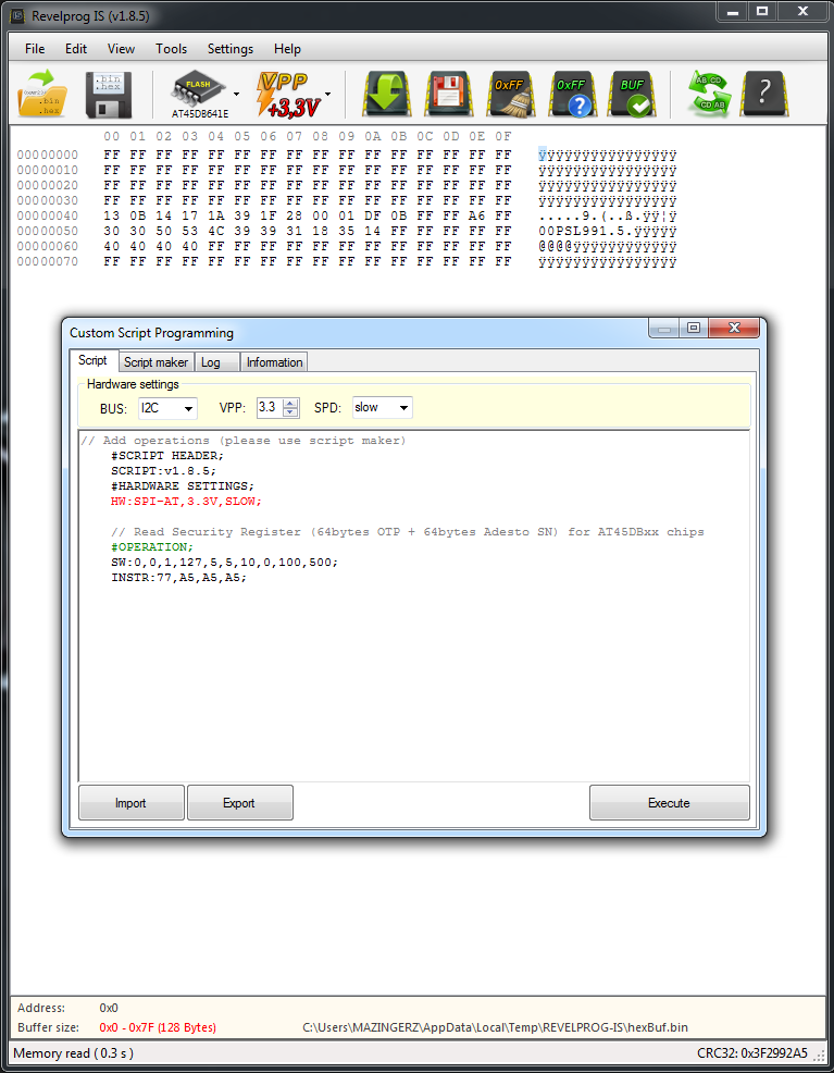

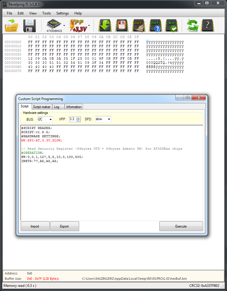

I have managed to execute the script, look at the data that appears.
comandos lectura datos ocultos flash Adesto.png (108.24 KiB) Viewed 7689 times
Re: Write verification operation failed flash memory Adesto AT45DB641E
Postby ArT » Wed May 04, 2022 10:15 am
Ok so we can see that there is no additional data stored in OTP (first 64 bytes which may be programmed by user are empty). The remaining 64 bytes of the register are factory programmed by Adesto and will contain a unique value for each device. The factory
programmed data is fixed and cannot be changed.
You can check if this S/N (or part of it) is used somewhere in FLASH in working device (maybe it copies the value after first initialization run). Definitely your alarm system has some kind of clonning protection and now you need to guess how it's implemented and this is not easy task..

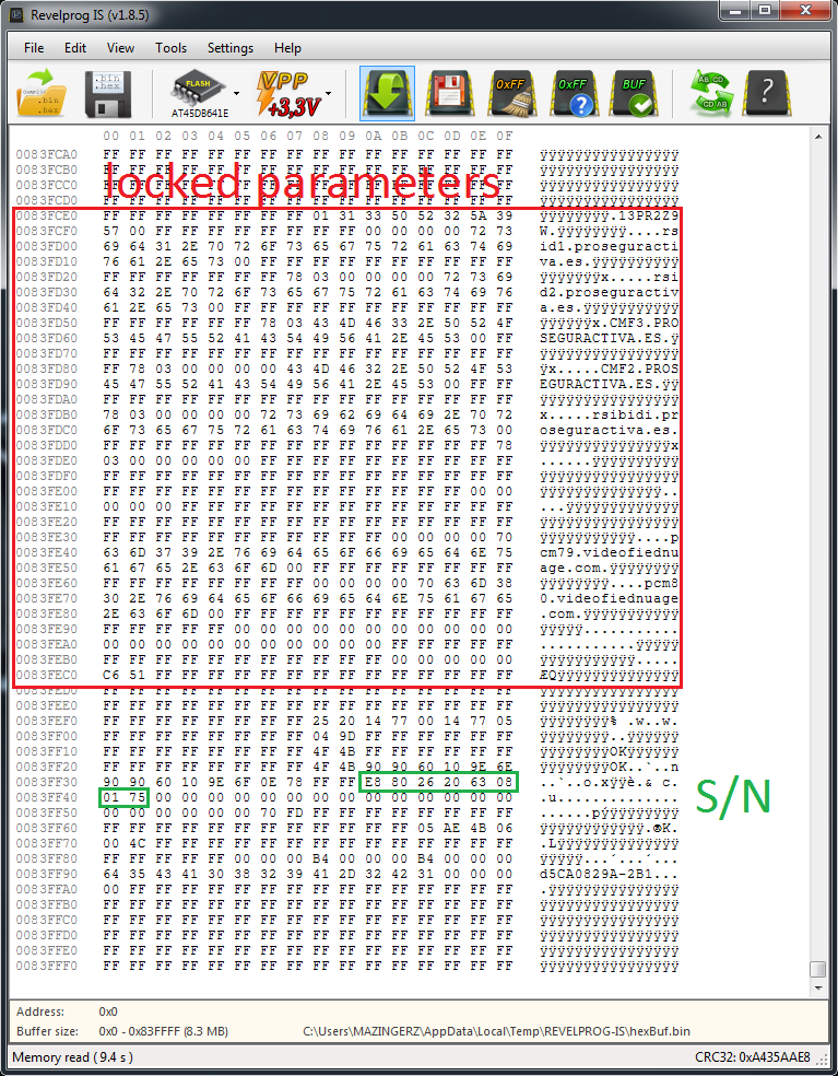

I enclose an image where you can see the blocked data, all the changes by FF hexadecimal value, with which I can delete them, write the flash memory and the alarm starts correctly, canceling the block. The s/n is right there, but it does not coincide with the reading using the script that we have carried out.
I have read with the script to another flash memory of another alarm (attached image), and the values change, I have also tried to write them but it cannot be modified as you comment.
My goal is to be able to read a flash drive, perform the unlock, and be able to write to a new flash drive.
