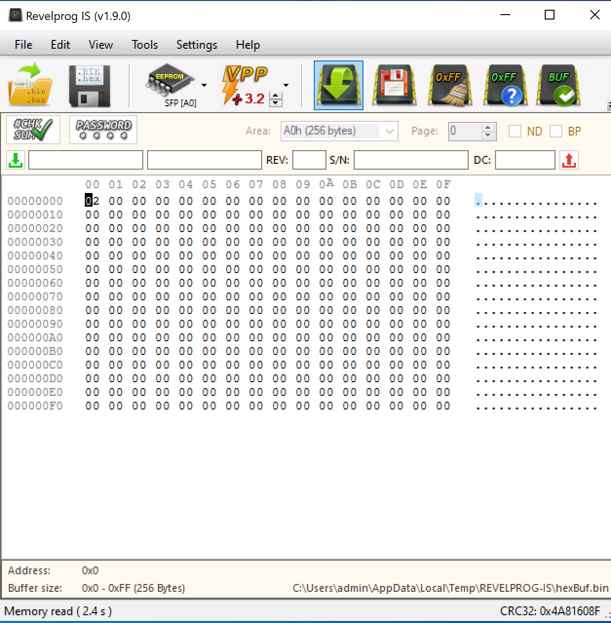

I tried to change SN on SFP GPON Unifi (UISP Fiber Instant https://eu.store.ui.com/collections/operator-ufiber/products/uf-instant).
But during Read memory to buffer, no manufacturer name, part or revision number, in fact all fields are empty (see results in screenshot)
Have you already experienced this?
In comparison, there is no problem with SFP UACC-CM-RJ45-1G https://eu.store.ui.com/collections/unifi-accessories/products/sfp-accessory to Read memory to buffer and display all information.
I guess SFP GPON Unifi is little bit different, maybe need to adjust Revelprog settings?

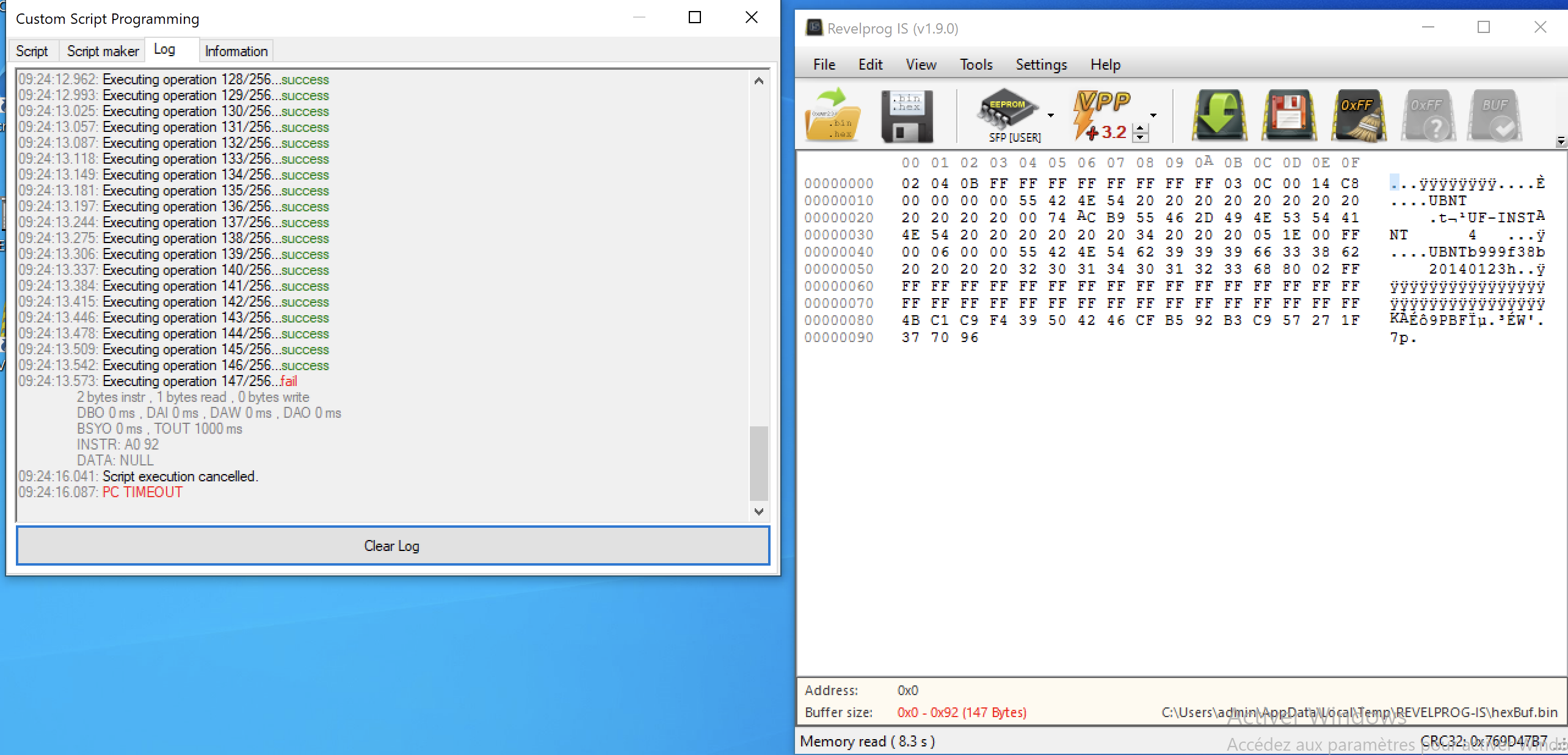

I tried SFP[USER] then select area: page 0, unfortunately first result was: PC TIMEOUT
Next tries has also return an error: OVERCURRENT PROTECTION
Below full log
09:40:38.559: Executing script started.
09:40:38.574: Setting hardware (I2C 3.2V SLOW)...success
09:40:39.294: Executing operation 1/2...success
09:40:39.324: Executing operation 2/2...fail
2 bytes instr , 128 bytes read , 0 bytes write
DBO 0 ms , DAI 0 ms , DAW 0 ms , DAO 0 ms
BSYO 0 ms , TOUT 1000 ms
INSTR: A0 80
DATA: NULL
09:40:41.730: PC TIMEOUT

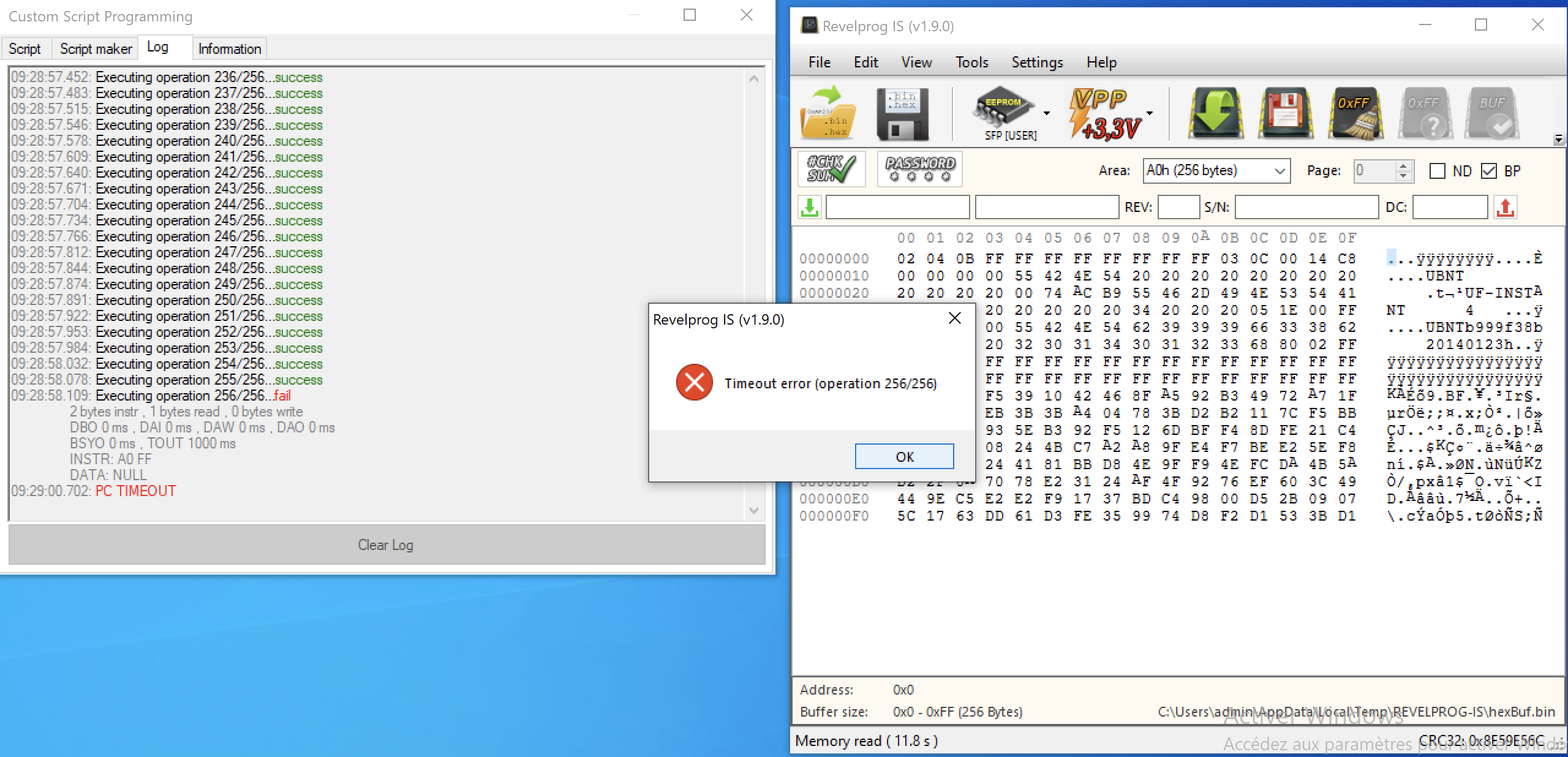

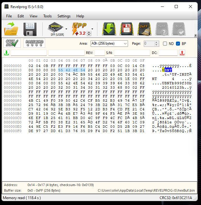

Ok, so "SFP [USER]" with A2 block and flag BP give more results, but each try has ended by PC TIMEOUT (see screenshots)

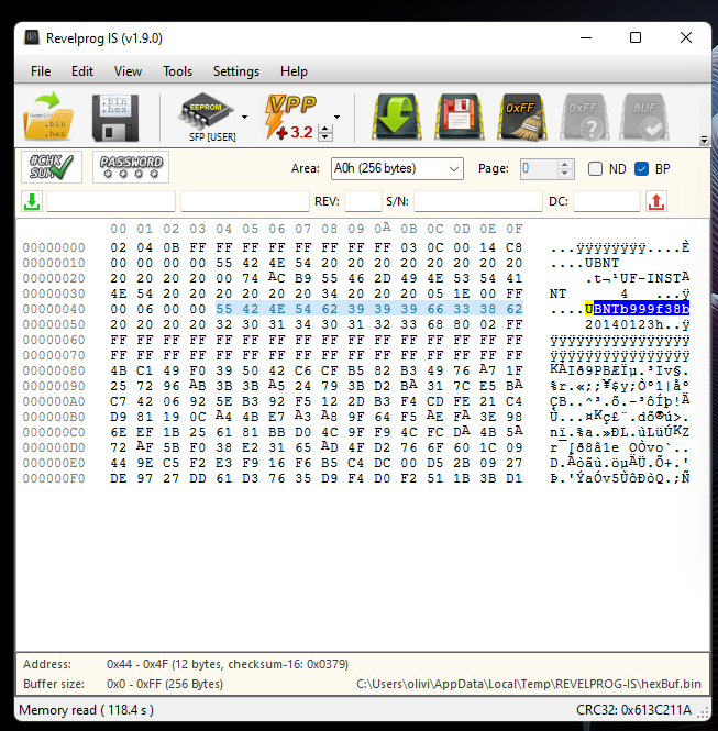

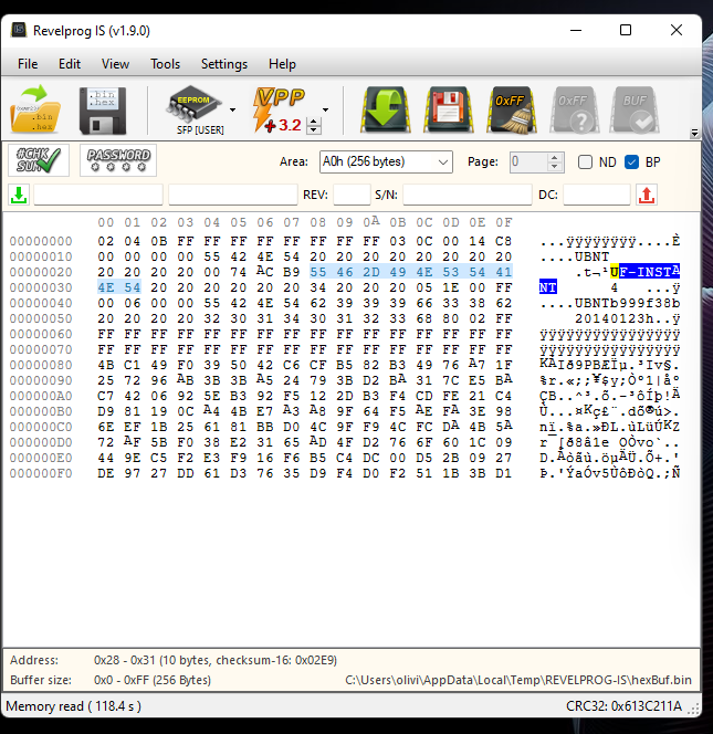

Based on MSA standard (pages 9-10 https://members.snia.org/document/dl/25916) vendor name is stored in bytes 20-35 and s/n is stored in bytes 68-83. What values do you have in these fields?
hexley
Posts: 7
Joined: Tue Nov 29, 2022 10:32 am
Re: UISP Fiber Instant
Postby hexley » Sat Dec 10, 2022 9:38 am
So, after checks, it seems information (model, manufacturer, SN) don't respect MSA Standard (see screenshot).
