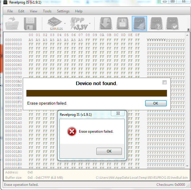

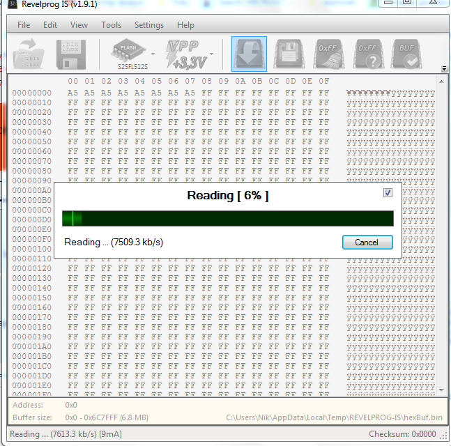

Postby NikS » Mon Aug 14, 2023 6:57 pm
I don’t understand what the problem is the inability to erase the chip
25FL512S
reading works
put the chip 25Q64 reading, erasing everything works
the programmer not long ago received an interpretation and started working with it, despite the guarantee, he decided to solder the components, but this did not help, because he needed it very urgently
What do I need to do ?

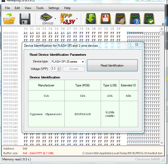

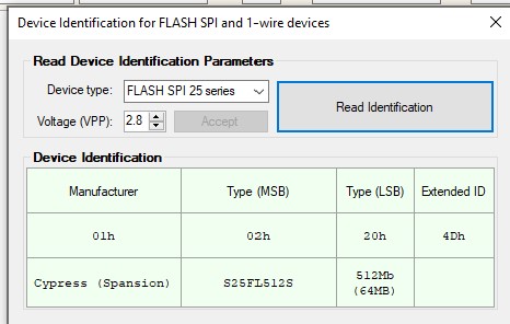

Programmer is fine. It has to work. But why are you using +2,0V voltage? :) This is 3V chip, read maybe will be working at 2.0V, but write requires minimum 2.7V (max 3.6V). Please check it at 2.8V. If it will not work you can try with 3.0V or 3.3V. If it still not work, issue is with pin contact - please clean memory pins with alcohol or IPA and clean socket pins too.

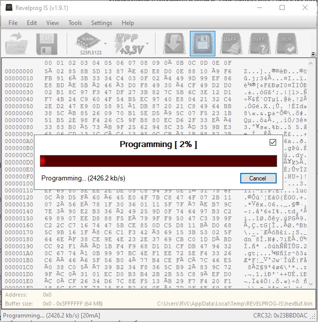

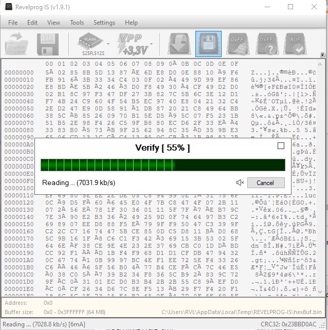

Zrzut ekranu 2023-08-30 110604.jpg (142.6 KiB) Viewed 12021 times
Zrzut ekranu 2023-08-30 105921.jpg (147.47 KiB) Viewed 12021 times
Zrzut ekranu 2023-08-30 110130.jpg (144.37 KiB) Viewed 12021 times
Zrzut ekranu 2023-08-30 105836.jpg (35.31 KiB) Viewed 12021 times

Postby NikS » Mon Oct 23, 2023 12:02 pm
I checked the capacitor in place, it is visible through the gap, I have two microcircuits and both behave the same
I checked all the contacts many times, I used another computer and I don’t understand what the problem is
