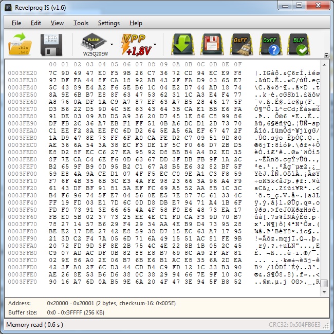

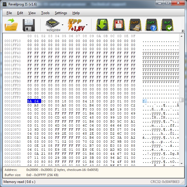

Programmer reads good only the first half of rom memory (you can see on pic that good part starts with pattern 5A 04 at offset 0x20000h on programmer buffer memory), second half part is truncated at offset 0x40000h (pattern B8 52).
The first good half part of rom memory got definitely shifted in second half part on Revelprog buffer memory.
Winbond 1,8V.jpg (40.47 KiB) Viewed 11116 times

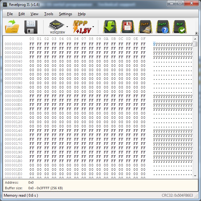

junk data.jpg (243.82 KiB) Viewed 11118 times
first half begin.jpg (246.3 KiB) Viewed 11118 times

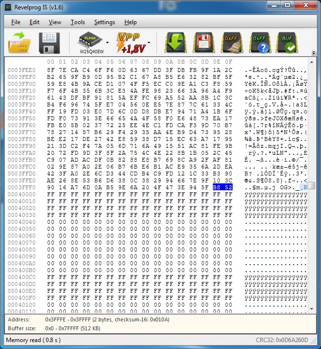

I was able to read complete ROM memory by selecting chip W25Q40EW on device selection, which is 512 KB memory.
I saved buffer memory on BIN file.
Read 25Q20BWVIG rom by selecting 512 KB W25Q40EW rom.jpg (281.14 KiB) Viewed 11116 times

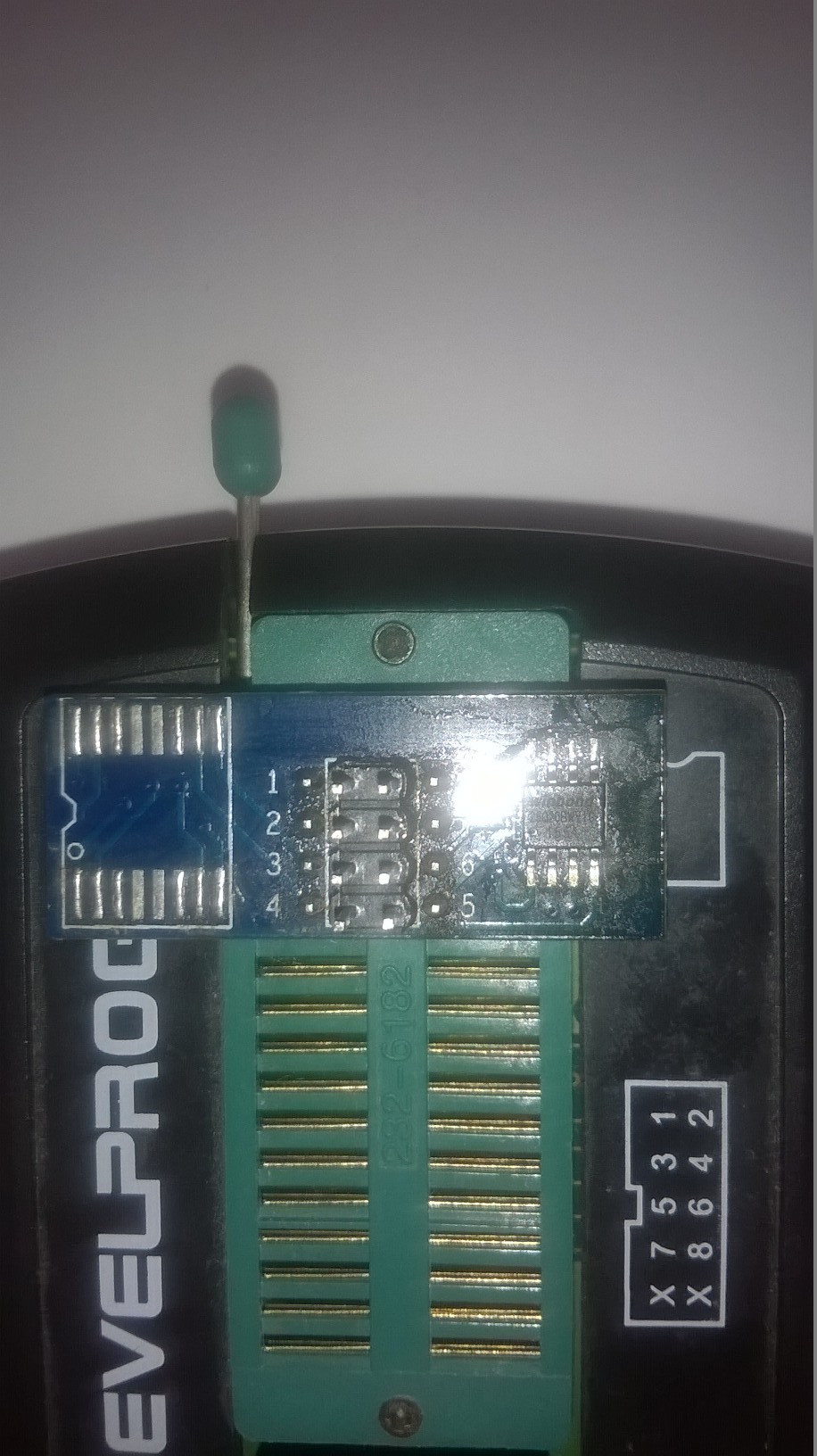

I can't send you the chip because is of my customer hard drive, but i can show you the pic
You might get identical hard drive somewher and dump the firmware with WDMarvel Demo

I soldered chip on my adapter because when i try to read it from included adapter, i always get some little differences every time i try to read it.
I compared bytes from saved files with Hex Workshop, if i read rom when the chip is direclty soldered on my adapter i get always same bytes reading (this means that pins connection is better when they are soldered).
I don't feal safe to write directly on my customer chip, in the data recovery field we DRs try to avoid it as much as possible, even if i already did a dump.
