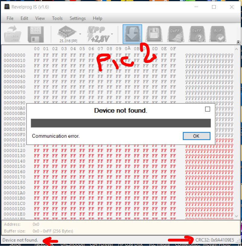

I have problem with my Revelprog IS since update, I got error CRC32: 0x9A4109E5
I have updated to latest version, in software down to the left it says: Programmer is connected (v1.6.1)
You can see in the pic 1.
Then when I try to read or flash a chip then I get CRC32: 0x9A4109E5 and in software down to the left it says: Device not found.
You can see in the pic 2.

Drivers are fine, and software looks fine. Programmer can't communicate with your device (communication error). Displayed checksum (crc32) is from empty buffer (all 0xFF). In v.1.6 programmer verify communication status during read (in v1.5 it was possible to read with interrupted communication but read buffer was incorrect). There are many possible issues why it can not communicate - first of all - what exactly device do you want to operate and are you trying to communicate in external circuit or in dedicated adapter?

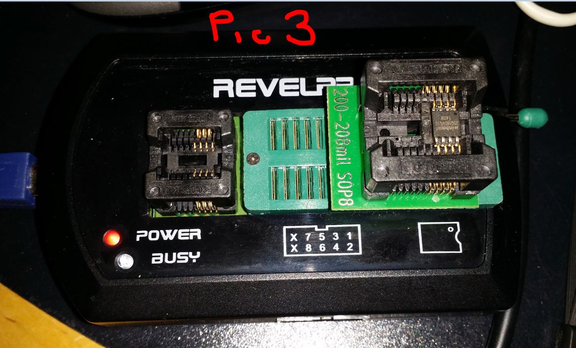

It's same with both methods It won't work, neither external circuit or with dedicated adapter ( I have SOIC-8 200mil )
you can se in pic 3

I forgot to mention I use to flash PC bios chips
