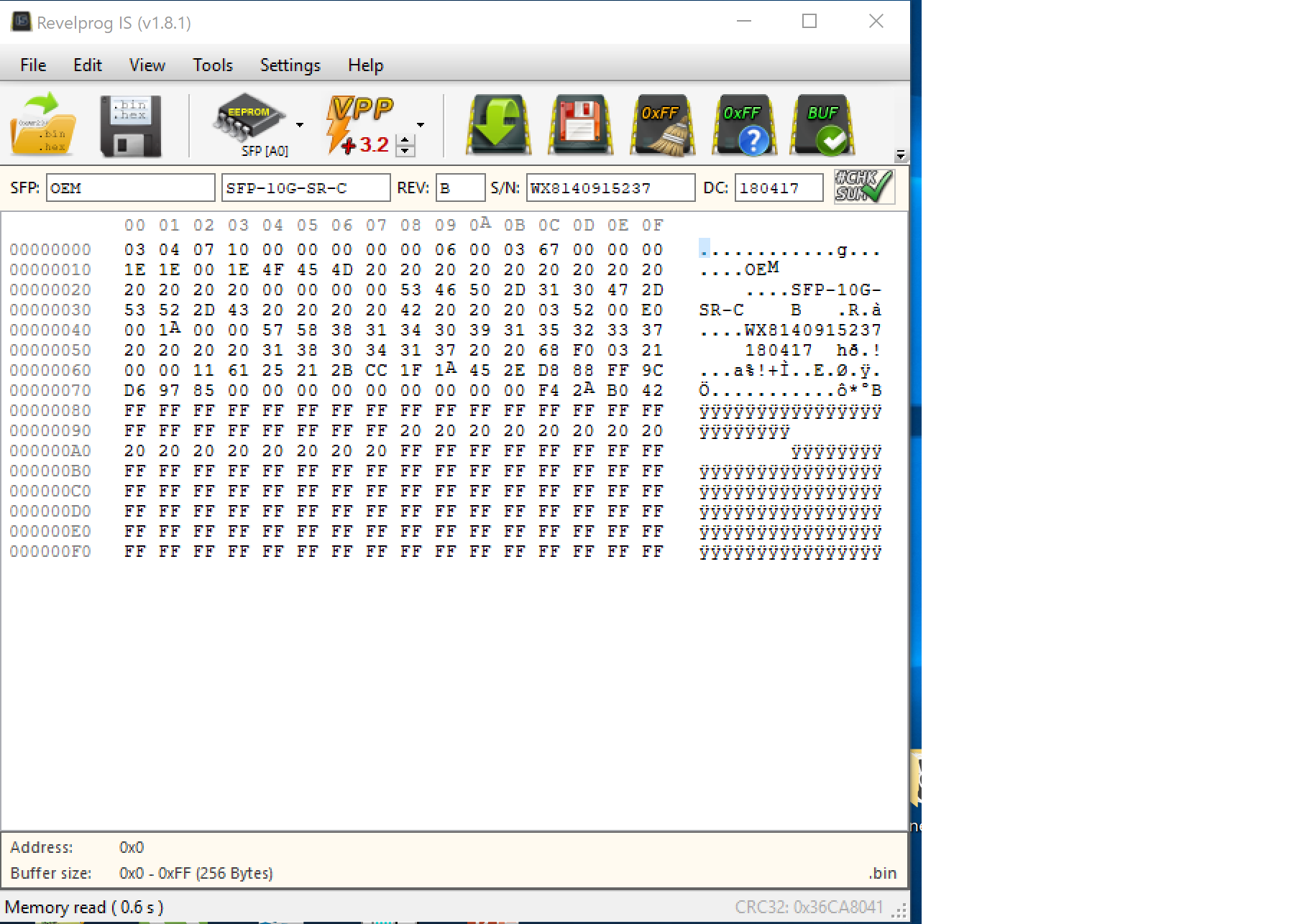

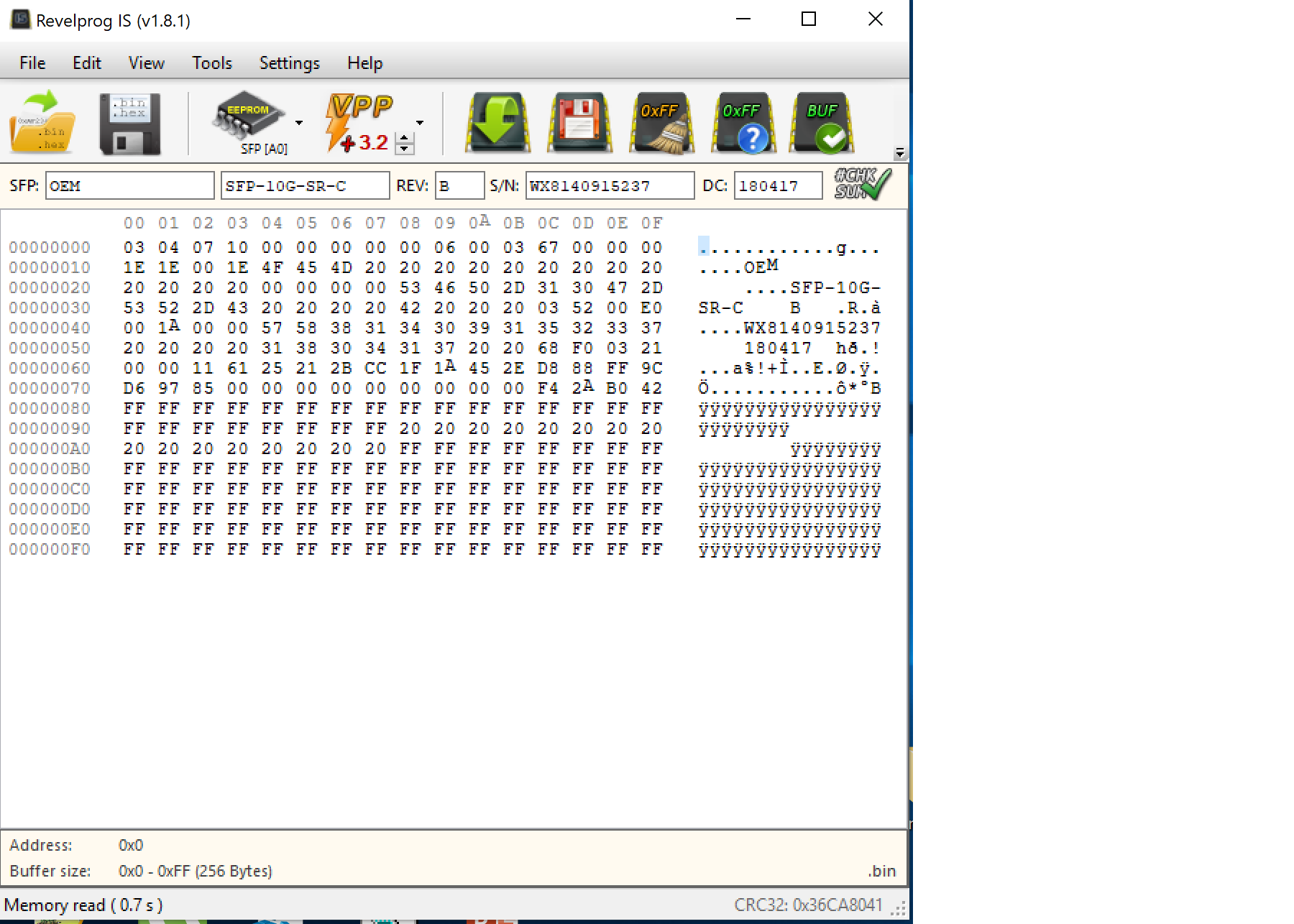

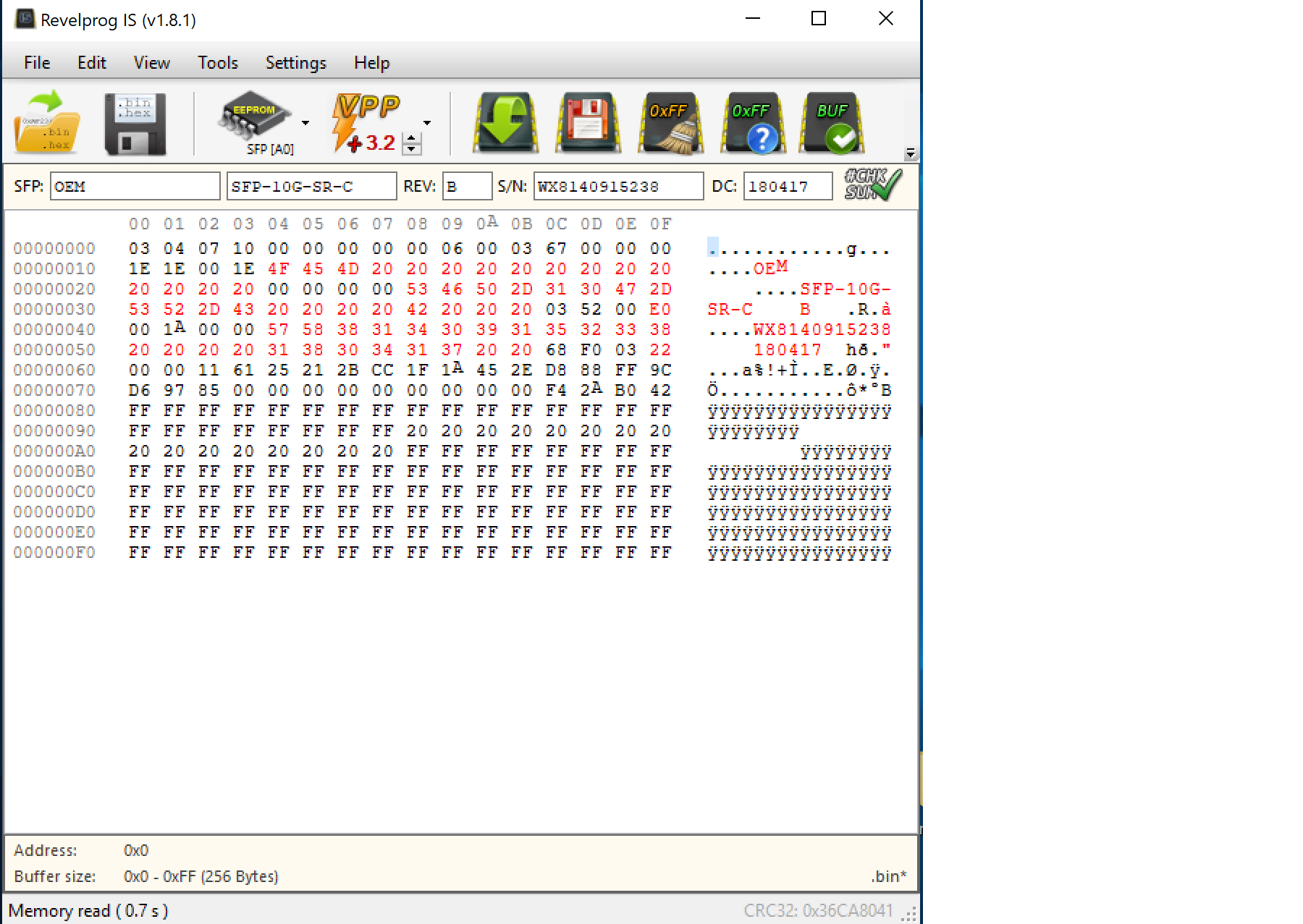

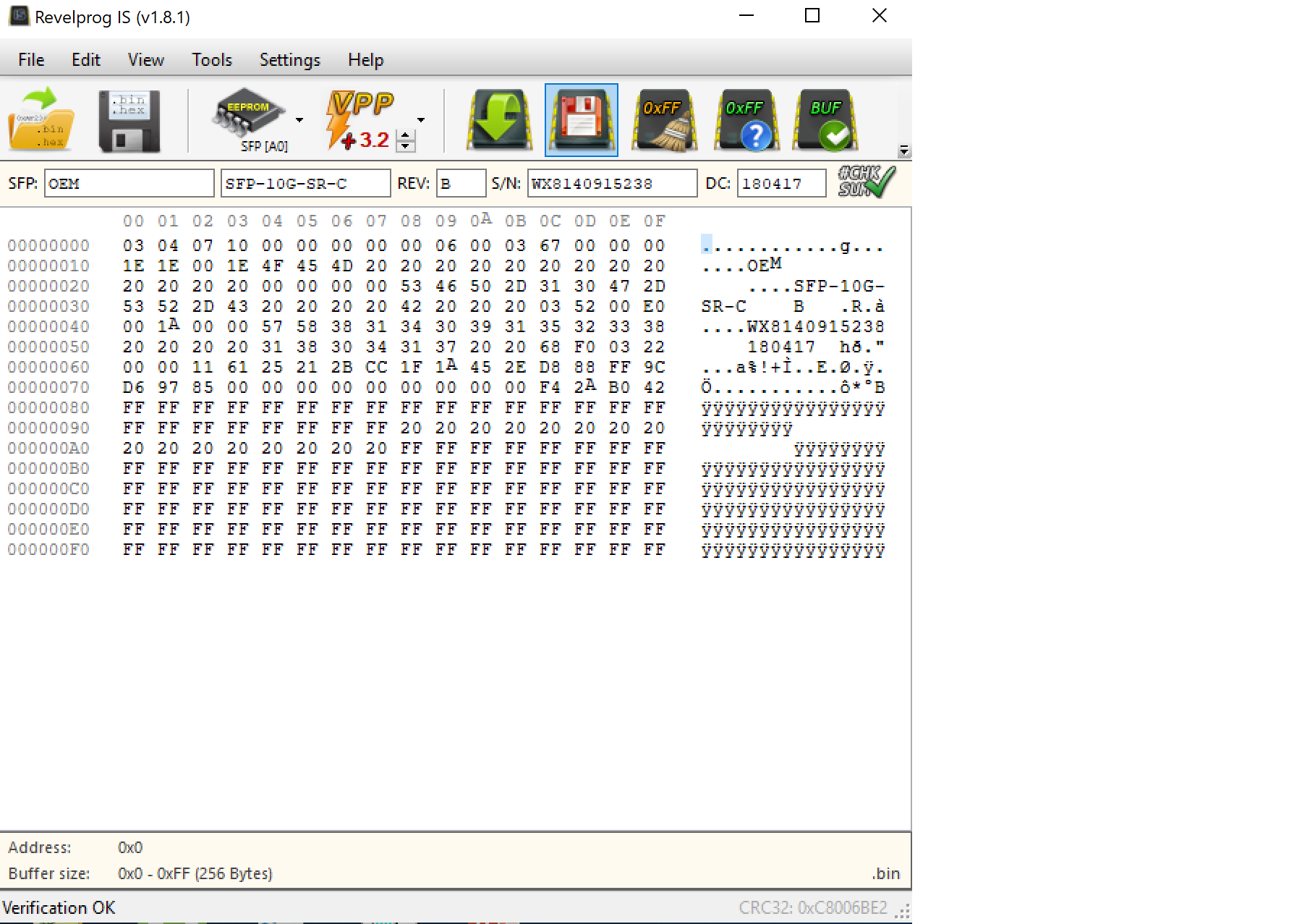

Here is the process with pictures attached
step 1.- Plug the optic and read the info
step 2.- Change the serial number and recalculating checksums
step 3.- Write buffer to memory
step4.- Unplug and plug the optic and read the info again
And as you can see the data is still old data. How can I know if there is a password?

Postby ArT » Mon Oct 14, 2019 7:32 pm
It looks like it is some kind of protection implemented in SFP.
Do you have SFP datasheet? I guess it is write protected or it is hidden procedure for write (maybe described in datasheet).
