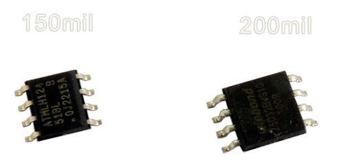

I think that you used SOIC-8 200mil adapter (on picture is SOIC-8 150mil). Most (but not all) FLASH SPI are in 200mil package.
Datasheet for LE25FS406, page 2, available packages: MSOP8/MFP8 (both compatible with SOIC-8 200mil), VSON8N and VSON8:
SOIC-8 150mil:
SOIC-8 200mil:
