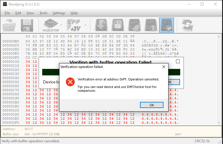

Thank you for bug report. I've just tired to reproduce it but everything is working correctly.
I did:
1. read MX25L25735F
2. select range from 0x0FF to 0xF801 (I checked also with range from 0x01FF to the end)
3. fillted with pattern 0x01 0x02
4. clicked verifify with buffer
Result:
Verification error at 0xFF
2020-11-04 121911.png (74.49 KiB) Viewed 6682 times
Could you reproduce my steps and confirm that problem exists? If yes, please try to save buffer after editing (all editied bytes marked with red will be black) and then try to verify or write - any difference?

I suppose you selected the wrong range.
I can reproduce the problem only with the last 2047 bytes, from 0x01FFF801 to 0x01FFFFFF.
If I modify even a single byte at 0x000000FF, then the "verify" detects it
Re: Verfiy doesn't verify the full range
Postby ArT » Wed Nov 04, 2020 4:13 pm
I checked and reproduced it with addr 0x01FFF801 to 0x01FFFFFF.
You are right that verification function does not compare last N packet. With N-1 is working fine. Write is ok for whole buffer, read also is ok. The problem is only with verification with last packet. I added it to TODO list and it will be fixed. Thank you for reporting it. At this time workaround is to read device with read function and compare buffers with compare tool.
