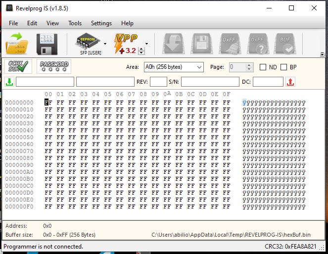

Postby AbilioPereria » Tue Jun 15, 2021 9:01 pm
I got an update message and I proceeded to update
I have a not connected message (picture attached)
It was working with 1.8.4
Regards,
Abilio

Re: Update from 1.8.4 to 1.8.5
Postby ArT » Wed Jun 16, 2021 11:01 am
What was previous step? Have you updated it or cancelled? Probably you started update and cancelled and now programmer is in update mode. Just disconnect programmer and connect again and it will back to normal mode. Or you have cancelled update process during erasing or write - in such case firmware is corrupted. Or you have updated only software and skipped firmware update (in such case you have programmer in v1.8.4 and software in v1.8.5). Please let me know in details about your previous steps.

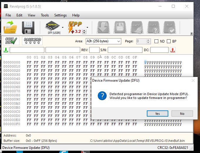

Postby AbilioPereria » Wed Jun 16, 2021 12:37 pm
I have updated the software and the update finished normally.
Now ii reports 1.8.5 software version.
Then then software requested a firmware update. I done it, and it seemed to end normally.
Powering off and on the programmer doesn't change the status.
When I exit software and run it again the firmware update box (image attached) appears again.
Postby ArT » Wed Jun 16, 2021 12:59 pm
Dear Abilio, it seems like firmware update process not finished correctly and programmer still starts in DFU update mode. What happen if you click "yes"? It should clear old firmware and upload new firmware and then restart in normal mode. I can make you video if you wish how update process looks like.

Postby AbilioPereria » Wed Jun 16, 2021 7:04 pm
I have done exactly the same, but the programmer gets stucked on Device Firmware Update (FDU).
At the end of the update it doesn't switch to normal operation.
I have uninstalled 1.8.5 and install 1.8.4 but the result is the same.
The programmer don't switch to normal mode.
If you want to have a remote access to my PC just let me know.
It must have something to do with the update because when I install it from the scratch it worked find.
Is there any programmer factory default feature?
Regards,
Abilio
Postby ArT » Wed Jun 16, 2021 8:53 pm
Hmm it's strange. Could you check it on other PC?
I can take a look via team viewer, please check pm for details.

Postby AbilioPereria » Thu Jun 17, 2021 11:35 am
Working.
I installed on another PC and the programmer switched from update to normal.
When plugged on my PC again it worked.
Thanks,
