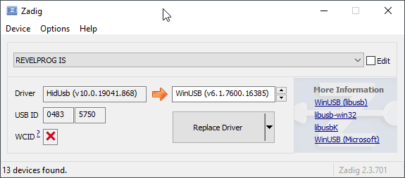

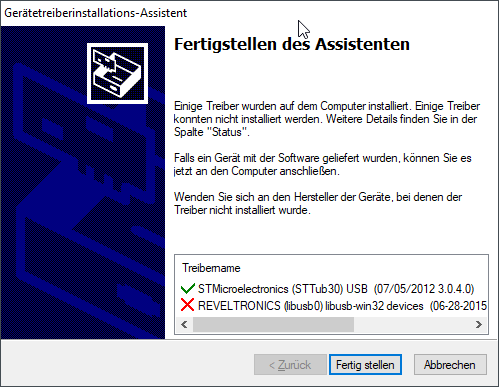

After several years I now need the programmer again and installed the latest version on Win10, followed the instruction installing the driver and the zadig filter driver. The Revelprog is shown as "Revelrog IS" under WinUSB devices in the device manager.
Unfortunately the programming software doesn't recognize the Revelprog.
I watched the zadig driver installation video on youtube and I am a bit confused about the VID/PID. At the video the VID is 0483 and the PID 5751. My Revelprog shows 0483/5750.
How can I make the programmer recognized by the programming software? Any ideas?

Re: Revelprog IS not recognized by programming software...
Postby ArT » Wed Jul 21, 2021 10:59 am
Version v1.2.x worked on standard HID windows drivers.
Since v1.3 there are other drivers (device is much faster)
Please install v1.2.4 (you will find it here https://www.reveltronics.com/downloads/ ... h/archive/) and it should work on standard windows drivers (you should not install zadig drivers)
If you would like to update to latest version, first you will need to install v1.3, it should detect your v1.2.4 and update to v1.3.0. Then you will need to install new drivers (with zadig) and then you can install latest software and update to latest version.
Here you have more information about driver changing after v1.2.4 viewtopic.php?f=23&t=61
Hope it helps. If you will need further help, please let me know

Postby dl9sec » Wed Jul 21, 2021 12:30 pm
great stuff, worked like a charm :D
Thank you very much.
