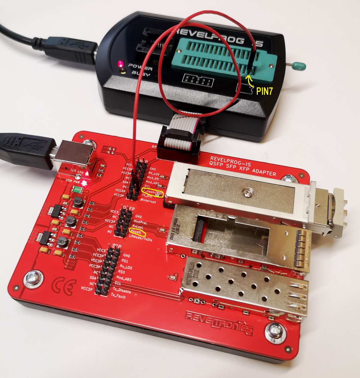

How to automate XFP resetting with REVELPROG-IS and QSFP SFP XFP Adapter:
  • connect XFP RESET pin to REVELPROG-IS pin 7 (see picture below):
    - XFP reset pin = P_Down/RST,
    note: QSFP will work only with manual reset. SFP does not have reset pin.
