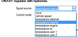

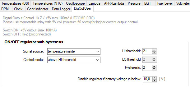

I would like to show you new feature in UTCOMP-PRO v3.4 (update coming soon)
As you can see, in UTCOMP-PRO currently digital output on pin B7 (DigOutUser) is not used- it will change soon :D Since v.3.4 there is possibility to control digital output switch based on selected signal source. As signal source you can choose any temperature or vehicle speed. Digital output state may be switched between two states: +5V and Hi-Z (disconnected). Recommended load is <50mA (maximum 100mA), so in most cases it will be used to control monostable relay switch with 5V coil.

Input signal source:
  • temperature inside the vehicle
  • outside temperature
  • engine or cooling temperature
  • oil temperature (e.g. for engine or gearbox)
  • user temperature
  • vehicle speed

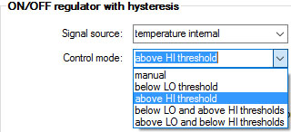

Regulation modes:
  • above upper (HI) threshold
  • below lower (LO) threshold
  • above LO and below HI thresholds
  • below LO and above HI thresholds
  • manual mode
Additional regulation conditions:
  • possibility to set hysteresis
  • possibility to set minimum battery voltage for regulation (ability to disable regulation when battery voltage drops below selected value, e.g. regulation is enabled only when engine is running)
