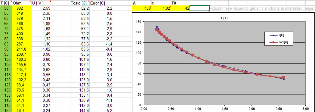

I have received my device and have completed wiring it. I have a question about the NTC oil temperature sensor. On my spreadsheet, I cannot get accuracy closer than +/- 5 degrees over the range of 50-150C (122-302F). My sensor ohm range is 992 (50) to 48.1 (150), and for 5.2V using A=130 t=1.02 T0=42 I'm off by -4 @ 50, +5 @ 70, and then +9 @ 150. The closest it gets is +1 @ 90. I have input a lot of different values and can't get as close as I'd like.
I'm not a spreadsheet expert. Are there any tips for making the curve closer to my thermistor? It seems like there should be some type of formula to calculate optimum values for all three.
Installing the UT Comp Pro on my car

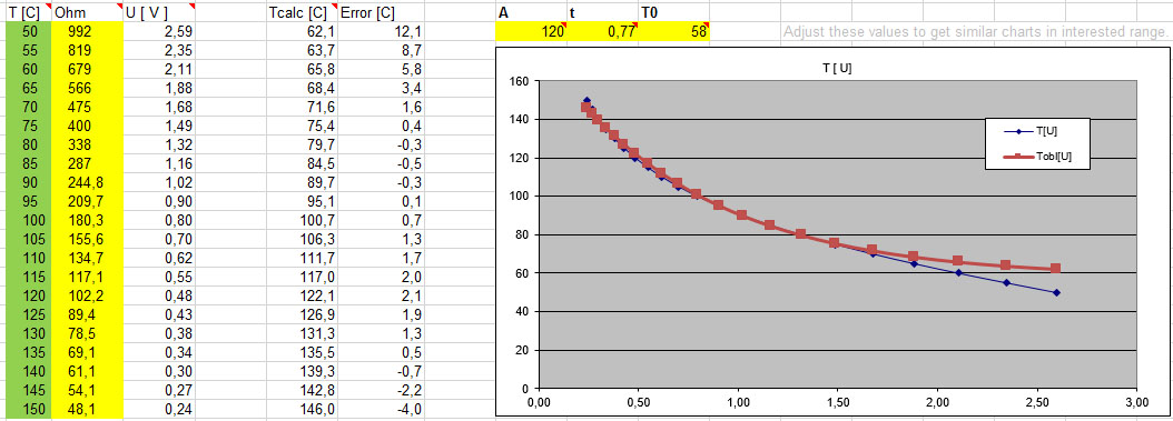

Postby ArT » Tue Feb 07, 2017 2:27 pm
It will be quite hard to scale it for low value temperatures because this sensor has typical NTC characteristic above ~60C
I assume that you need it for oil temperature, so I scaled it for 80C range (from 65C to 145C)
A = 120 t=0,77 T0 = 58
please take a look at error column:
Your values are also not bad - it will be less accurate for crytical values but you have scaled it for wider range.
Excel in attachment.
NTC_daily_driver.xls
(71 KiB) Downloaded 1475 times
At the moment I do not have access to origin software but I'll check it on origin as soon as I'll have access to this software.
